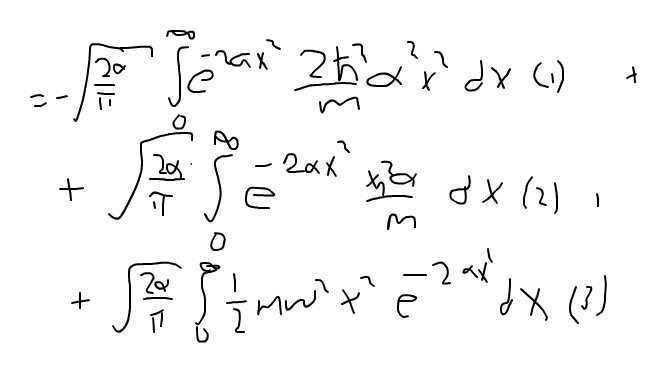

I forgotted the complex term, but i used it when i calculated the integral through. See my steps in whiteboard bellow:
https://www.physicsforums.com/attachments/85230
Here is the initial integral, <H>
Handwritten working splitting an integral into three terms, labelled (1), (2) and (3), each a Gaussian-type integral over x with exponential e^(-2αx^2) and polynomial factors.

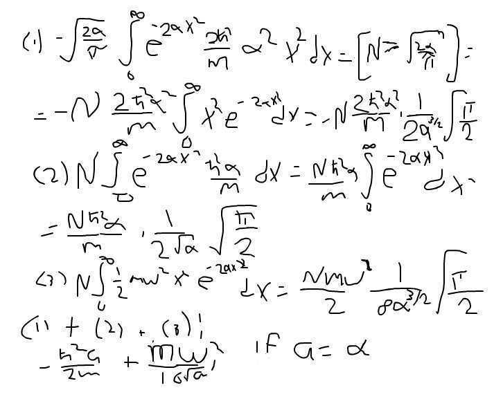

Here is I am dividing the integral into 3 different parts (1), (2) & (3). When i have calculated the 3 different gaussian integrals and have add them together again, i got the following result:
Handwritten expression: minus h-bar squared alpha over 2m, plus m omega over 16 times the square root of alpha.

So how did you calculate those separate integrals?
Explicitly, do you know the solutions of following integrals
[tex]\int_0^\infty x^2 e^{-\alpha x^2} dx[/tex]
[tex]\int_0^\infty e^{-\alpha x^2} dx[/tex]
What might help you here is introducing constants A, B and C for each factor in front of the integrals.
Afterwards you can simplify.
So now give me the values for those integrals as well as an expression for the result.

Handwritten derivation of three integral terms (1), (2) and (3) for a variational energy calculation, with a Gaussian integral and the result -h^2 α/2m + mω^2/(16√α)... written with the condition a = α.
I still got the same result. I got the solutions for the integrals from the Mathematics Handbook for Science and Engineering
How did you get different results for the integral ##\int_0^\infty x^2e^{-2\alpha x^2}## in your first and third part?
That's where your mistake likely can be found.
