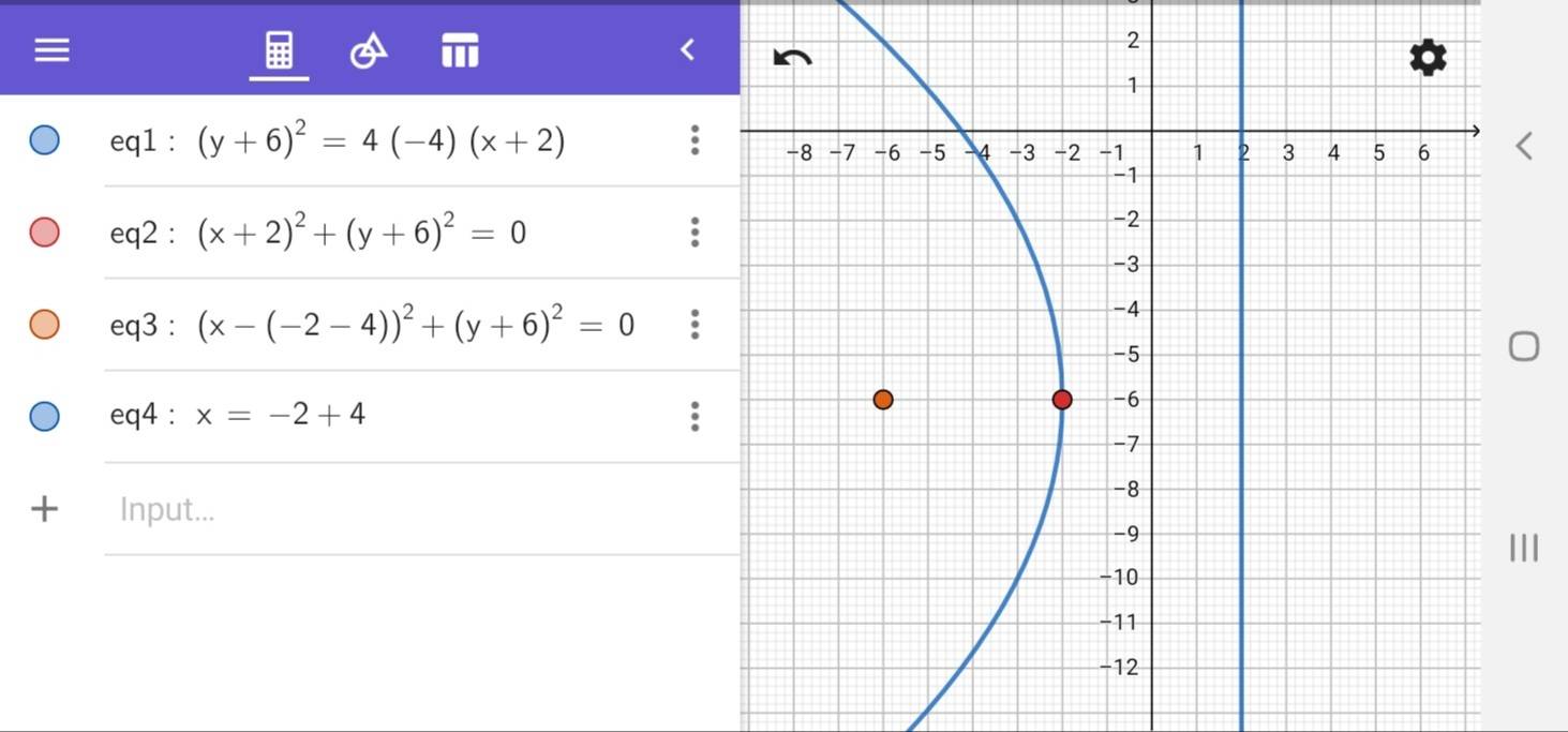

When I saw this a month ago, I plotted it with my graphing app along with the OP's y^2+12y+16x+68=0. They didn't match. I figured somebody will come along with a correction but nobody did. Forgot about it till I decided to remove a few open tabs and saw it again. I guess nobody here is no longer double checking.
That should have been
$$(y+6)^2=4(-4)(x+2)$$
Edit: Just realized something else. This thread is a year old already. Country Boy's post made me think it was just new a month ago.

Beer soaked correction follows.
Country Boy said:
$x= -\frac{1}{16}(y+ 6)^2- 32$.
$x= -\frac{1}{16}(y+ 6)^2- \frac{32}{16}$
Tequila soaked ramblings follow.
Country Boy said:
And $\frac{32}{16}= 2$! Yes, thank you.
It need not be said but this of course invalidates some the rest after
Cheers.
