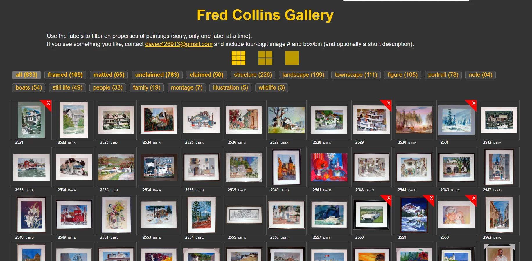

I built the gallery a year or so ago by-hand, to facilitate family and friends browsing and choosing any paintings they want. It has filter tags, resizing, and a sprinkling of useful metadata.
Screenshot of the Fred Collins Gallery web page: a grid of painting thumbnails, each labelled with a four-digit image number and box, with filter tags such as framed, matted, unclaimed and landscape along the top.
At its heart is a single .JSON object containing all 800+ items:

Every time someone asks for a painting I've got to go in and update this .js file manually, then upload it to the server. A single missed comma or quote, and the whole thing bricks. My brother just asked for a dozen.

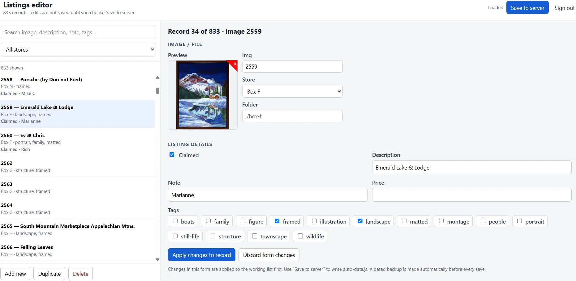

So I have been jonesing for a control panel that
  1. eliminates crashy typos and discourages uncrashy typos.
  2. works directly online, so I don't have to laboriously edit it in Notepad, then save the file, then upload it to the server every time.
I was on the verge of asking my PHP friend how much he'd ask to do it for me, when I thought I'd give ChatGPT a shot at it.
All it did was ask me for my data file and it
  • built an entire CRUD (Create, Read, Update, Delete) interface to operate it,
  • guessed the field types, including the multi-select tags I was using for filtering,
  • created a one-time setup file so I could create my own a password access,
  • implemented the list/line-item layout, a keyword search, a filter, two-level save, cancel, dupe and delete,
  • supplied user prompts before committing to data-altering operations,
  • left my data file exactly as-is, in human-friendly format with my inline, comments, in case I want to (or have to) fall back to operating it manually,
  • used the proper PHP methods to encode the data, so it handles things like quotes gracefully (being a flat data file, it is also immune to SQL injection attacks),
  • troubleshot a compatibility problem with the version of PHP my webhost uses. Replaced the 8.0 function with one that works with my webhost's PHP version,
  • produced a README.TXT file to tell me exactly how to implement it and run the setup.
It did this all on its own without being asked.
The whole endeavor took maybe two hours - and 1.5 of those hours was me asking for aesthetic tweaks.
Here it is. One page, one file:
