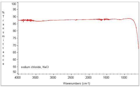

For an assignment (not really homework, but not really exciting either), I'm trying to calculate the total entropy for the reaction:
Na2 + X2 [tex]\rightarrow[/tex] 2 NaX
Where X = F, Cl, and Br . ( I told you this isn't exciting). Also, in this theoretical reaction, everything involved is an ideal gas. As part of my calculation, I need to find the stretching frequency (in cm-1, but I can always convert units to that) of the following molecules (ideal gasses, again): Na2, F2, Cl2, Br2, NaF, NaCl, and NaBr.
What is the best way to go about calculating these?? I was thinking that I'd simply look at the infrared spectra, but I cannot find any... Can I calculate the "force constant" of the bond somehow (modeling it in a sort of classical way) and then, from that, calculate the stretching frequency/IR absorption?
Chemistry news on Phys.org
Well, apparently it was staring me right in the face.[tex]\omega_{e}[/tex] is the vibrational stretching frequency I was looking for (I'm just not familiar with spectroscopic notations...doh!).
Here is NaCl spectrum.
That'd be because most of the species you mention are homonuclear, so they're not IR active. (you'd need IR-Raman spectrum) Otherwise you can look at the http://www.nist.gov/pml/data/msd-di/index.cfm"
And there are tables of Morse potential parameters for diatomics out there, (which includes the force constant)
That'd be the second derivative of the energy with respect to the coordinate distance, hence it's explicitly dependent on the energy, and the wave function, and a complete description of all the electrons. You can't calculate that classically; there's no property of a chemical bond you can calculate classically.
You're trying to create a (semi-)classical model of a chemical bond, which is to assume an effective potential that's a harmonic oscillator or Morse potential. But the only way to determine the parameters for that model is to fit them to experimental data, or to do an explicit quantum-mechanical calculation. Most QC programs will automatically, on doing a frequency calculation, do the entire calculation of the partition function and thermodynamic properties. So I'd assume you're intended to find some experimental values.
Calculating the IR frequencies given a harmonic-oscillator or Morse potential model is covered in every phys-chem textbook, really.
