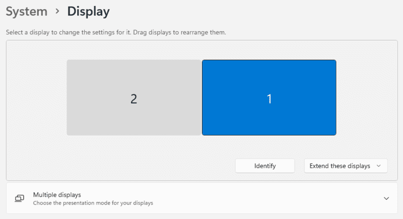

Just got a new fire TV and in HDMI1 mode (show computer video) it only shows the background of the monitor
I just got my first fire TV and in HDMI1 mode (show computer video) it only shows the background of what shows on the monitor. My previous TV with a firestick showed everything although I never did get the sound to work through the HDMI cable.
In the NVIDIA control panel, it shows the fire tv hooked to the HDMI output of the graphics card (a Geoforce GTX 1050Ti) AND I can change the orientation of the image on the TV (without changing what's on the monitor) and the brightness / contrast / etc.
What I CAN'T get it to show on the tv is anything other than the background including the task bar at the bottom but none of the desktop icons and none of app windows. When I put the mouse pointer inside the task bar, that shows up on the monitor but not on the TV.
The video card has outputs for VGA, DVI, and HDMI and my ASUS monitor, on which everything shows up, is using the DVI output.
Anyone have any idea what I'm missing?

I don't see either of those (extend/duplicate, and "advanced display settings"). I have multiple displays selected, else I could not have had anything show up on the fire TV.
In that case that the TV is showing an Extended Desktop. It is not showing any icons or windows because you have not moved them to the extended desktop.
You need to work out which direction the desktop has been extended in. You can do this by trial and error - move the mouse off the edge of your main monitor to the right and left and maybe up and down, off the diagonals and see if it appears on the TV. Alternatively hit the start key or icon and type "duplicate display". It will then show a window similar to this so you can move things around (you can see I have my second monitor on the left), or if you find this too confusing change "Extend these displays" to "Duplicate these displays".

Ah HA ! I was only accessing the functions available in the NVDIA control panel. Now that you've pointed out the WINDOWS functions, it all works.
Thanks, guys.
