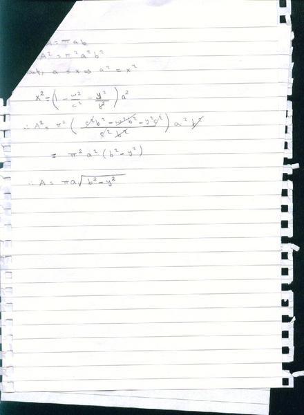

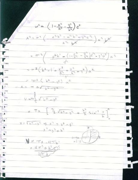

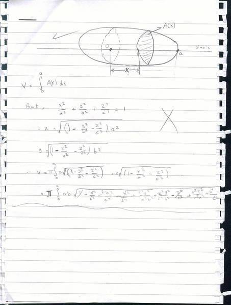

These are my trials
I have the idea but can't get the right answer
pls reply
THNKX

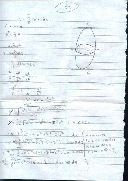

Continue:

In your first sheet, you start with [tex]\int A(x)dx[/tex] and then immediately switch to [tex]\int x y[/itex] without a "dx" at all. How did that happen? I also cannot see any good reason for writing x as a function of y and z <b>and</b> writing y as a function of x and z.<br /> You are correct that [tex]y= b\sqrt{1- x^/a^2- z^2/c^2}[/tex] and that [tex]z= c\sqrt{1- x^2/a^2- y^2/b^2[/tex]. The first tells you that when z= 0, [tex]y= b\sqrt{1- x^2/a^2}[/tex] and the second tells you that when y= 0, [tex]z= c\sqrt{1- x^2/a^2}[/tex]. In other words, at each x, the cross section is an ellipse with semi-axes [tex]b\sqrt{1-x^2/a^2}[/tex] and [tex]c\sqrt{1- x^2/a^2}[/tex]. Do you know that the area of an ellipse with semi-axes a and b is [tex]\pi ab[/tex]?[/tex]
hmm … let's start at the top of your page 3 …
w² = (1 - x²/a² - y²/b²)c²
which I take it is following my suggestion …
tiny-tim said:
So what is the equation (in x and y) if you put z = w (a constant) … ? :smile:
… and then what is the area? :smile:
And then you try to use the formula A = πab for the area of an ellipse.
BUT … that formula only applies if the equation for the ellipse is in the standard form, with nothing but x² and y² on the left and "= 1" on the right.
You must put w² = (1 - x²/a² - y²/b²)c² into that form first.
Then you will get a "new a and b" that are not the same as the original a and b.
ok … rearrange w² = (1 - x²/a² - y²/b²)c² into the standard form … and then find the area. :smile:
