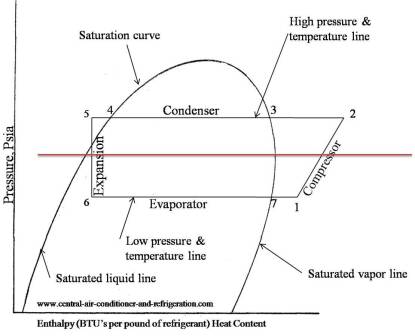

Now, we're getting somewhere! I finally found a refrigeration diagram on the Web, that I could cut-and-paste over to Physics Forums.
That's a start:
