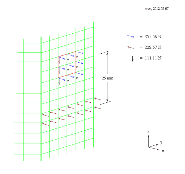

Vadar2012: Your calculations in post 6 look fine, except you would want to use a factor of safety.
Vadar2012 said:
So would it be plausible to just apply the weight on the hook as a vertical force at the node on the wall?
No, you would need to also account for the applied load offset (moment). Perhaps try the approach shown in the attached diagram. Let the applied load on the hook be P1 = 1000 N (random load on hook). Therefore, the corresponding nodal applied loads, which you should apply on each corrugation ridge, are shown in the attached file. You can stiffen the plate elements in the red box by setting E = 2e6 MPa, representing the flat washer footprint.
Scale the wall stress results by P2/P1, where P2 = hook load such that wall (and bolt) is not overstressed, using a factor of safety.

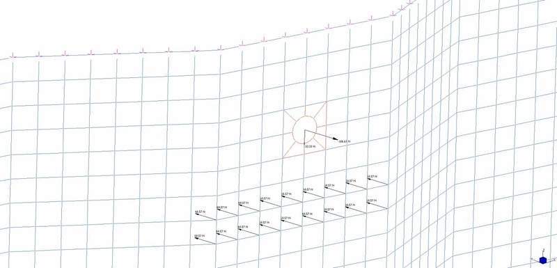

So about the model. How did you calculate those forces? I get much larger ones for a 1000N load (just applying trig using the geometry in my previous attachment). I'd like to apply a load of 300N this way.

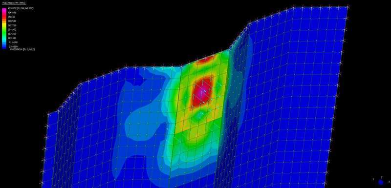

I applied those forces to my model and got the results shown in the attachment. As you can see they are far above the 350MPa yield strength of the material (max is 450MPa), which is weird, because we know it can take far more than 100kg. I already tried increasing the mesh density. Appying the forces further down from the top and to a larger model with more of the sheet gives the same results.
I also drew the bolt hole in the model and restrained the nodes that made up the circle to a master node in the centre. I then exended this centre node out 80mm and applied a vertical force to it. Again, got results much higher than expected, but you would given the applied stress concentration factors.

nvn - I'd still really like to know how you calculated those force values to apply at the wall for the 100kg load, so I can apply it to a 30kg load. It would help immensley. I'm not one to ask without trying first, but I'v been unable to replicate it.
Vadar2012: 14 gauge steel sheet has a nominal thickness of 1.897 mm; and 14 gauge galvanized steel sheet has a nominal thickness of 1.994 mm. (Or if you want to include the tolerance, that is 1.897 +/-0.127 mm thick, and 1.994 +/-0.127 mm thick, respectively. Or a more common tolerance would be 1.897 +/-0.095 mm, and 1.994 +/-0.100 mm, respectively.)
From summation of moment about point A, you can obtain the bolt tensile force, Fb. Fb/(9 nodes) = (3.2*P1)/(9 nodes) = 3.2(1000 N)/(9 nodes) = 355.56 N/node.
From summation of horizontal force, the force at the bottom of the rectangular tube is Fb/(14 nodes) = (3.2*P1)/(14 nodes) = 3.2(1000 N)/(14 nodes) = 228.57 N/node.
The vertical force on the wall is, P1/(9 nodes) = (1000 N)/(9 nodes) = 111.11 N/node.
To change P1 to 300 N, change P1 to 300 N, above.
When you display the stress contour, do not display the elements inside the red box in my diagram. Omit those elements from the contour display.

The restraints I've applied are just around the corrugated steel sheet where the welds would be. Top, bottom, and left are all fixed, and the right side restraint is "Y sym" so I don't have to draw the whole damm thing. I don't know where you're going with that question, but keep in mind that picture just shows the top of the sheet, there's another set of forces half way down. Am I missing some restraints? Say to help simulate the washer/bolt on the container?
This is an obvious question, but just to be sure, this is just to simulate the hole without actually drawing it right? I could easily draw it and apply 355, 111.11 N at the centre node of it? (restraining all the radial nodes to a master centre node of course) This could elimate the contour problem.

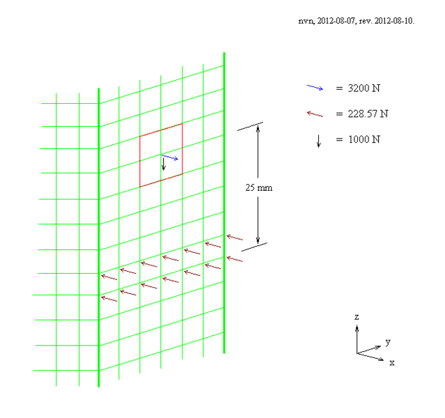

Vadar2012: I cannot think of any restraints you are missing, at the moment. Yes, the elements in the red box simulate the bolt, bolt hole, and flat washer.
The attached files, below, show a few other methods, corresponding to P1 = 1000 N. You can scale P1, as previously discussed, if you wish; or you can scale the stress results. For these second and third diagrams, you can use E = 2e7 MPa for the plate elements in the red box. You can also make the plate elements in the red box thicker, if you wish. For the third diagram, the blue element is an interpolation element, sometimes called an RBE3 element. The pink element is a short, very stiff beam element. The pink element is optional, but helps you read the force on the centre node, to see if the force is (Fx, Fz) = (3200, 1000) N.

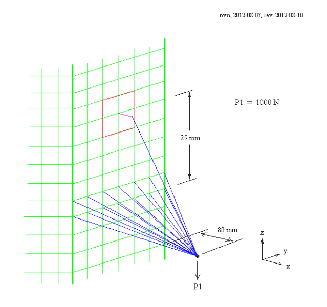

nvn - Nice methods, I'll try those too. What do you think about drawing the bolt hole and appying the forces to the centre master node?
Vadar2012 said:
What do you think about drawing the bolt hole and applying the forces to the centre master node?
Vadar2012: Sounds OK. The centre master node needs to be connected to all nodes underneath the washer, not just the nodes on the bolt hole edge.

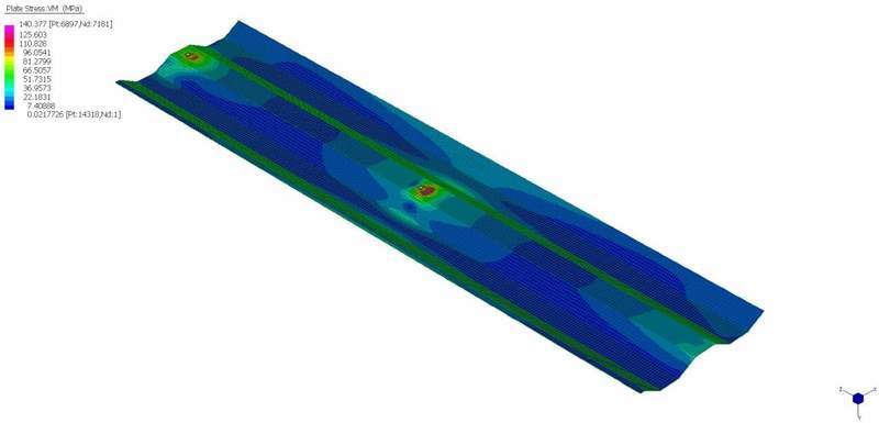

I think I finally got a model that gave me some decent answers. Results are attached. The red square is a different element and all circle nodes are linked to the centre master node. This makes it easy to get rid of the contours inside the red element. The results shown are only outside the red square (square is drawn as a different element and turned off after solving).
So this means that there's a safety factor of 2.5 given this setup and a load of 30kg. I really thought it'd be more than this though.
