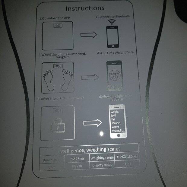

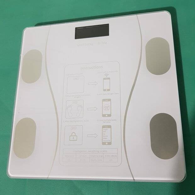

I bought generic china weight scale with FAT impedance measurement (no brand so not against forum rule). But examining it, there is no metal above the glass, the silver thing is inside the glass. Is it supposed to be like a capacitive screen in Ipad or is the silver thing a metal supposed to touch the feet skin in real equipment to measure the impedance?

They could have a conductive coating that you can't easily see, but I doubt it. I like your capacitive coupling hypothesis. Body fat impedance is an AC measurement; 50KHz or so.

I tried to wear socks and stand on the scale (shown before) and still get reading of fat, muscle mass, etc. in the app. I then stand on one foot still wearing the socks, and still got a reading. Is it supposed to work even with socks? I read below it passes small electrical current up from one leg to the other:
"How do they work?
Body fat scales are easy to use. You simply step on the scale, and the tool measures both your body weight and your estimated fat percentage.
Such scales work with the help of sensors underneath your feet that use bioelectrical impedance. When you step on the scale, a small electrical current runs up through your leg and across your pelvis, measuring the amount of resistance from body fat.
Then, the sensors in the scale measure the level of resistance that the current met as it travels back through your other leg.
Depending on the type of body fat scale you have, the information can link up to your smartphone or smartwatch, as well as any fitness apps you might have.
As a rule of thumb, greater body resistance means a higher fat percentage. This is due to the fact that fat contains less water than muscle, so it’s more difficult for a current to travel through it."
The big issue with these measurements is calibration to more accurate methods, like putting you in a tank of water. Do it the way they say to in the manual.
Unfortunately, many consumer products add features like this to get you to buy their product, or pay more for an additional feature. The consumer, on average, has no way to know if the numbers they report are actually valid. The manufacturer has more incentive to include a new feature then to prove it works well.
My heavily biased, and mostly uninformed, assessment is that this measurement is essentially only for entertainment value. Most medical types will just use BMI. Body fat isn't that important to measure well in a non-research context. Hence the lack of incentive to do it well.
