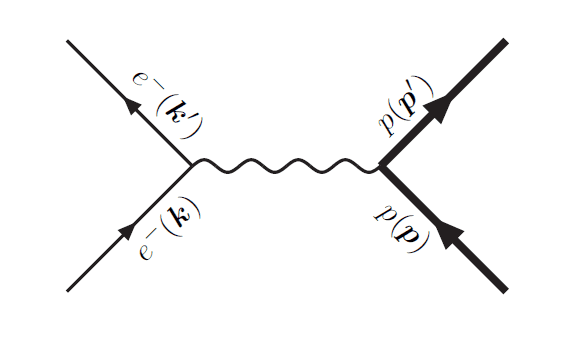

I am currently reading Particle Physics by Palash Pal. In one place, the author shows the Feynman diagram for the electron-proton scattering:
Then, he writes the Feynman amplitude for the process: $$i \mathcal{M} \ = \ \left[ \bar{u}(\vec{k'}) i e \gamma^\mu u(\vec{k}) \right] \frac{-ig_{\mu\nu}}{q^2} \left[\bar{u}(\vec{p'}) i e \Gamma^\nu u(\vec{p}) \right]$$ Then he writes,

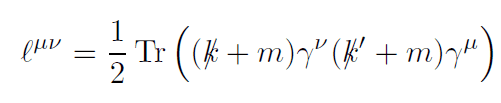

where,
and
After this, he proceeds to find the expression for the ##\Gamma## in ##h_{\mu\nu}##.
My question is, how does he write the terms for ##l^{\mu\nu}## and ##h_{\mu\nu}## just by looking at ##\mathcal{M}##? I am sure I am missing something, and the answer is very trivial, but since I have none to ask, I hope you will help me out.

Has the book gone through the identities for traces and contractions with the gamma matrices and polarization spinors?
Yes, it has, but not in great details. I might be forgetting something. I need to look those up.
They're essentially responsible for the result. I'd look them up again and remember what indices are being contracted.
