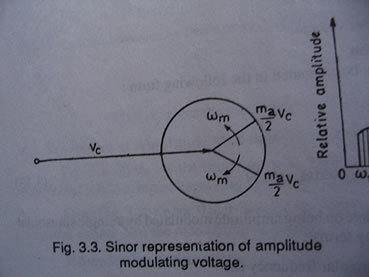

Thanks a lot mezarashi for the lucid explanation. It dispelled some doubts but a few more still remain.
Okay, So in the attached diagram, the Vc is totally real therefore it is on the X axis. And the length of vector Vc is it's amplitude. And it has no time component. (This is the phasor part of the diagram). Am I right so far?
The plot is that of an amplitude modulated signal.
V={Vc + Ka Vm Cos(Wm t)} Cos (Wc t)

Now I do not understand the two Wm near the curved arrows in the complex plane and the (Ma Vc)/2

Sorry I didn't reply earlier, because your attachment was not approved, so I couldn't see what you were talking about. Are you learning radio angle modulation already while learning circuit fundamentals like phasors? It's a relatively advanced topic. Your college must have a really weird cirriculum. I remember struggling in communications even in my junior year. Anyway.
The Vc is real, because this is the reference. We denote the carrier signal to be in phase, or phase = 0. This is just for simplicity. Angle modulation means that we encode our signal in the angle of the carrier signal. In the time domain, this looks like:

The diagram I posted was meant for amplitude modulation and not phase angle modulation.
In case of AM, the carrier is supposed to be changed in accordance to the instantaneous value of the modulating voltage. So Vc should be changing on the X axis.
So should I understand that the sinor is the vector sum of Vc+Wm?

The amplitude of the (high frequency!) carrier wave is changing -
but slowly, taking 100 carrier cycles for 1 modulation cycle.
The diagrams want to avoid having the big fast carrier wave rotation
ovwerwhelm the small slow modulation rotation.
To keep the V totally Real, (the traditional approach) is to
add TWO modulation sources: one positive frequency + one negative,
each with half the (total) modulation Voltage.
I would've drawn the two of them tail-to-tip so you'd see a Real sum.
Only EVER add Voltages to Voltages (never add Voltage to frequency!)
(but I'm sure you know frequencies add and sutract from frequencies
to make sideband , single or double ... ).
