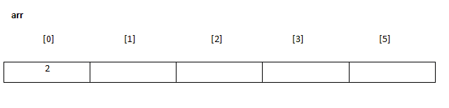

Please identify the contents of the array after the following manipulations.
int arr[5];
arr[0] = 2;
arr[1] = arr[0] + 1;
arr[2] = arr[0] * arr[1];
arr[3] = arr[1] / arr[0];
arr[4] = arr[3] * arr[3];
*Involves multiplication, addition from the array. Solve it...

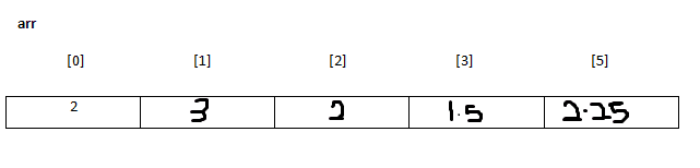

This is my effort. Just got confuse.

It isn't like that... (Shake) How did you find these results?

no, idea. But, I think the second expression is correct according to your explanation.

It should be like that:
[m]arr[1]=2+1=3
arr[2]=2*3=6
arr[3]=3/2=1
arr[4]=1*1=1[/m]
Do you understand why? (Thinking)

arr[0] = 2
arr[1] = 3
expression 3...
arr[2] = arr[0] * arr[1] =6, is because 2 * 3 = 6.

[m] arr[3]=arr[1]/arr[0]=3/2=1[/m]
We take the integer part of the number $1.5$ since [m]arr[/m] is an array of integers. (Nerd)

Oh, Thank you so much for reminds me that. Yeah! It's array treat 1.5 as integer.
