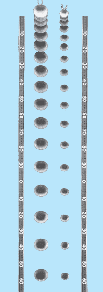

On page 179 at the bottom right hand corner there is what purports to be a multiflash photograph of falling balls. This cannot be a photograph but perhaps is an artist's rendition. Near the top of the figure, the later images of the falling balls appear beneath the earlier ones.
On page 242 in the middle of the page it says "the linearization gives 2 as the approximation for [tex]\sqrt{3}[/tex], which is not even accurate to one decimal place." I assume the author means that since the first digit of the square root is 1, 2 is off even in this place. However, it is necessary to round off the square root before making the comparison. Otherwise we would say that 2 is a terrible approximation to 1.9999999999999, it is not even accurate to one decimal place.
It may be an artists rendition of a photograph as opposed to an actual photograph but I
mean if you're going to call that an error I don't know what to say other than this kind of
pedantic slavery over language will annoy you to no end if you continue reading math
books :-p I think it's quite clear what he means.
Erm, "the later images of the falling balls appear beneath the earlier ones" is how
things look once they are dropped downwards. If you drop something it will appear
below the point you dropped it from (:smile:) Surely you meant something less
tautological and more error prone but I can't figure out what you meant, in any case the
picture does not look like it has any error to me other than purporting to be a real photo
as opposed to an artists rendition (despite the fact it's obvious what he meant).

sponsoredwalk, can you verify that the images of the balls taken later are layered behind the images taken earlier and not in front as they would be in an actual multiflash photograph?
Here is the photo:
Multiflash photograph of a row of spheres in a column falling past a vertical ruler marked in centimetres, with a second column of smaller spheres beside it.
Here is another multiflash photo:
[PLAIN]http://www.math.jhu.edu/~mathclub/book_covers/spivak_calculus.jpg
I think you can see that it's not so clear as to whether an image of something falling will
unambiguously appear on top regardless of where it is temporally. In fact you can see in
Spivak's book cover the author manipulated the coin aty different points for clarity (just
as most pictures of this kind are manipulated). Furthermore it's a drawing so I mean they
can hardly draw things perfectly & I honestly think it would be less clearer if he didn't draw
the picture at the top the way it's done, if I were an artist doing that I'd want to make the
top look clear to indicate what's going on.
  • Multiflash photo of a falling object: a column of evenly spaced blurred circles, with the sequence of positions measured against a vertical scale on the left and right.
sponsoredwalk said:
Furthermore it's a drawing ...
That was my whole point. The text says it's a photo.
