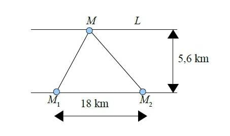

What are the lengths of lines M to M1 and M to M2 in this geometry problem?

line m2-to-m is 3km longer than line m1-to-m
what are lengths for ##M~~M_2## and ##M~~M_1##
pythagorean theorem hopefully can be used
use the picture to your advantage in hopefully creating a valid system of equations. With which, X and Y can both be solved.
However the question only asked really what was (X-3) and what was (X). Y should hopefully only be used as an intermediary variable to that purpose(?)
system of equations is as follows:
$$y^2~+~ 5.6^2~= ~x^2$$
$$(18-y)^2 ~+ ~5.6^2~ = ~(x-3)^2$$

##x= \sqrt{y^2+5.6^2}##
the lower equation can be reduced into the form of...
##y^2~-36y~+346.36= x*(x-6)##
insert top equation into the lower equation. Hopefully this was correct because on pen-paper-style it took an entire page, really...
##35y^2 -630y +2724.89=0##

y = 10.7736967
y= 7.226303295
We can test these Y's and hopefully to ascertain whether or not the system is true.
I think that with the top value of Y (y ~ 10.773 ...)
the originatl system of equations seems to work ok.
testing can be done with calculator for example with assigning variables with some values such as
y=10.7736967
from the top equation we plug in the y value, and calculate that x should be equal to about 12.14218022with that x value, you can plug it into the lower equation and it should hold true.
so it looks like length of x = 12.14218022 km
it looks like length of (x-3) = 9.142180224 km
feedback or critique is welcome. Especially if I was wrong ... (obviously...)
also alternative tactic of solving is welcome.
maybe this is dumb question but how can a person know for a fact. WHICH side from a given triangle with a 90deg angle, is supposedly the hypotenuse of that particular triangle? Without knowing strictly the lengths of sides at first instance?
There is an easier way. If you take the difference of your two original equations the quadratics cancel, leaving you a linear relationship between x and y.

I assume you mean, if you are given two side lengths and the fact that the triangle is right-angled, but don't know the relationship between that and the given lengths. If so, you cannot tell. In a2+b2=c2, you can plug in any two values for a and b and solve, or plug the larger in as c and the smaller in as a and solve.

In your first equation, you have a y2 on the left and x2 on the right. If you expand the parentheses in the second equation that will also have those squared terms. If you subtract the first equation from the second (left from left, right from right) you will have an equation with no quadratic terms in x and y.

You did not post all your working, but it looked like you would get a quartic equation that would take some work to simplify. My method avoids that, never being worse than a quadratic.
late347 said:
theres about 4 main ways to solve systems of equations
Those methods, as general methods, are for linear equations; these are not.
The equating method does work here, and is what you used. I suppose you could consider my method as an example of the summation method.
