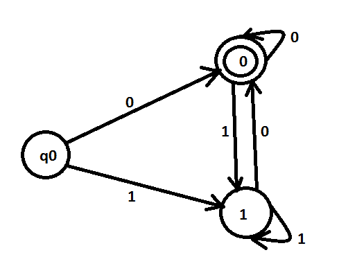

"Give the definition of a FA (without a graphical representation), which accepts binary numbers $n$ which are without remainder divisible by $2 ^ k$ for all $k \in \mathbb{N} \setminus \{0\}$."
Could you help me understanding which automata is meant?

Hi! :)
That looks a bit like a trick question, or else it is worded badly.
Is that the literal problem statement?
Whichever number $n \ne 0$ you pick, there will always be a $k$ such that $2^k > n$.
If we divide that $n$ by $2^k$ the remainder is $n$, so $n$ does not qualify.
Taken literally, only numbers of the form $0+$ qualify.
I looked again the exercise and thought the following:

Each number is divible by $2$ if the remainder of the division by $2$ is $0$.
The possible remainders of the division by $2$ are: $0,1$.

So the DFA is the following:
Is this correct?
  • State diagram of a DFA with start state q0 and two states labeled 0 and 1; the state 0 is accepting (double circle). Transitions: q0 to 0 on 0, q0 to 1 on 1, 0 loops on 0, 0 to 1 on 1, 1 to 0 on 0, 1 loops on 1.

Your DFA would properly accept a binary number that has no remainder when divided by 2. (Emo)
However, the problem statement requires that the binary number should also have no remainder when divided by 4.
Nor when divided by 8, 16, 32, ... ad infinitum.
I do see that your DFA could be modified to allow for that.
Effectively it would only accept a string of 1 or more zeroes.
Btw, the problem statement asks for an FA without graphical presentation. So it should be in the form of a set of rules together with their context.
