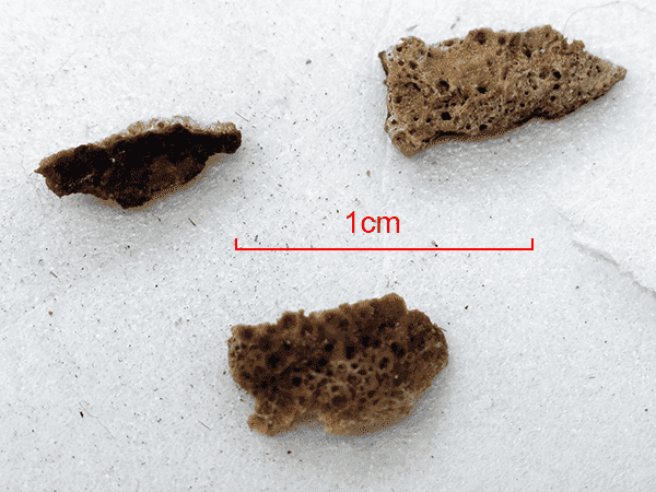

Plaque of calcium built up on my submersible glass aquarium heater Why here and why brown? And mostly, is there some electrical cause?
A have a deposit of calcium on the glass heater in my (freshwater) aquarium that does not seem to look or act like deposits I am used to.
To address some of the obvious questions:
A sample of it got nice and fizzy in a puddle of vinegar, so I have little doubt it is calcium.
I know calcium tends to build up on emerged surfaces in aquaria - especially reptile aquaria which require calcium supplements. This seems different.
It is not white; it is not powdery or delicate; it is not crumbly.
It is a medium grey-brown, very compact* and smooth** and hard enough that I risk breaking the glass trying to dislodge it with a knife.
*by compact I mean it is not spread out or patchy or uneven; it is a single, thick mass (1/8"), like a slug, in a very specific spot (next to one of the heater elements)
** by smooth I mean it has no fronds or fragile bits - it is like an old rock that has had all its rough bits worn off
The mass looks like this at least 1.25" long. No other deposits anywhere else on thermometer:
I found this thread that talks about calcium being "burned" onto the glass.
Questions:
  • Does calcium deposit differently in the presence of heat?
  • Is it possible the compact shape is derived from needing a "seed" to grow from, like a snowflake does (I forget what that's called in chemistry)
  • Why would this deposit grow so compactly? Is there some ionizing issue attracting it to deposit there, such as current leakage?
This is just a tiny sample. Piece on left has a glass-smooth inner surface

Are there similar deposits elsewhere in the tank?
Brown stuff in freshwater aquaria is often "diatoms" (AKA brown algae), which usually have silica shells IIRC.

Calcium carbonate might become trapped among them as they grow.
The higher temperature of the heater may aid in its deposition.

No, nowhere else.
This stuff is rock-hard - like coral. Needs to be broken off with a metal pick.

Yes, electricity is what is piquing my interest.
If the glass were cracked, I'd expect to find condensation and rust inside the glass heater from ingress.

My best bet would still be on brown algae, encrusted in some way with the calcium carbonate, a favored by the high temperatures. Kind of like a stromatolite.

It is possible that the deposit has been forming on the hottest area of the glass, as the glass encloses a resistance that may not heat up the entire length of the glass tube due to modulation in order to keep a preset temperature.
I have seen apparently similar formations on the transfer surfaces of some steam boilers where water has not been properly treated.

No. Calcium is a shiny metal. Fizzing suggests it is a carbonate. Most likely calcium carbonate.
Brown/red colors often mean presence of iron, not that uncommon in tap water. Doesn't mean I reject diatoms explanation, I actually quite like it.

As I vaguely recall, the minerals in common tap water have lower solubility in hot water than in cold. That's why the hot water pipes, and heater, in your house clog up sooner than the cold water pipes.
That leads to the suspicion that there is a hotspot on the heater. Try replacing the heater (and the water!).

Hot spots in those kind of heaters are common.
My understanding of the greater clogginess of hot water pipes is the combination of a source of dissolved minerals (from the hot water heater and nearby pipes), combined with a lower solubility in the cooler peripheral plumbing (especially when the water is not flowing).

Thanks. Those two things combine to make a perfectly plausible explanation for my phenomenon.
