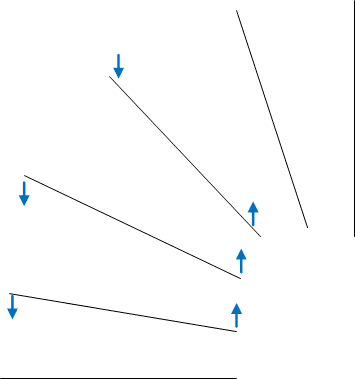

In this notes , i was told that there is an increase in pressure along the inner wall
IMO , it should be there is increase in pressure at the outer wall , as we can see , the outer wall is longer , so the water would flow slower, resulting in the increases in pressure , am i right ?

On the lower left of the picture, planes of equal pressure are horizontal. On the right vertical. They have to change orientation but are reluctant to do so (inertia).
On the inside, the liquid has to 'brake': it wants to flow faster but is held up. So pressure is rising.
On the outside the pressure drops to accelerate the liquid.
Velocity profile follows (Bernoulli)
I've only drawn a few blue arrows to suggest this.
In the horizontal direction something similar happens

whaty do you mean by On the inside, the liquid has to 'brake': it wants to flow faster but is held up.? how can the liquid be held up ?
Hehe, you ask good questions. I'll have to look up a few things that I seem to have imagined wrongly... (what I wrote is contradicted by figure 2..., but I do like figure 3, at least if my interpretation is right...)

I didn't reply to this thread originally because it made no sense to me either. I was hoping someone more expert might explain it. Anyway, here's my inexpert 2c.
One problem with the "has to go faster" argument is that there is no obvious reason why it has to keep up.
The referenced text mentions centrifugal forces. The argument from that, surely, is that a net radially inward force must exist, which implies higher pressure on the outside. Since that implies the outside flow would slow down into the bend (relative to the inside flow, at least) it suggests the creation of a counterclockwise eddy.
so , the notes is wrong ? the pressure at the outer wall should higher than the inner wall ?

Clearly, even my interpretation of fig. 3 was wrong ands the pressure at outer wall is higher -- and consequently (?) the velocity is lower. So the first paragraph of your notes is disproved and my defence was ill-advised.
I still think
that this is not a cause-effect relation, but that's only as a physicist (and obviously I'm not a fluid flow expert :frown:).
Some aspects of this elbow flow are counter-intuitive, others make sense. Thank you for bringing it up in this critical manner !
I particularly like the (page 14)
It is this horizontal gradient that is ultimately responsible for keeping the flow turned along the axis of the pipe
and it would be interesting to check (by calculation or from experiment) the claim in your notes that the insertion of guide vanes eases the situation and reduces the pressure drop. My bet is that it does.

can you explain, why the pressure at the outer wall of pipe is higher?
Do you understand that a centripetal force is needed to get the flow around the elbow?
Yes
foo9008 said:
Yes
So where will that force come from?
the force of water to make the water to rotate around the bend ?
But something has to apply the force to the water.
so, how it relate to pressure at the outer and inner wall of bend?
Consider a part of the flow that's adjacent to the outer wall. That gets a normal force from the wall to push it around the bend. Now consider a part next to that, just a bit further from the wall. At constant velocity it would run into the first part, creating a higher pressure. That higher pressure creates the normal force that pushes it also around the bend, and so on.

What's wrong with the diagrams on pages 13 and 14 of the SAND report linked from post #14? They give a very complete view.
The velocity map shows that two helical (corkscrew) flows arise, one in the top half and one in the lower half. Where they meet, both flows angle across from the inner wall towards the outer wall. When they reach the outer wall, the top half flows, at an angle, up the wall and loops back over the top towards the inner wall. Correspondingly, the lower half flow moves down the outer wall and loops back around the bottom of the pipe to the inner wall.
The flow across the halfway level, from inner wall to outer wall, is driven by momentum. The flow is against the pressure gradient and so is slowing down. Having reached the outer wall, and lost its momentum in that direction, the excess pressure there pushes the flow back around top and bottom curves to the inner wall again.
