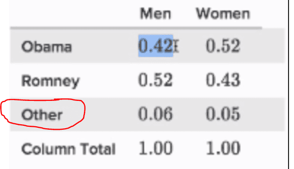

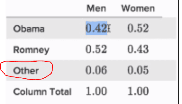

I'm not sure that the term "frequency table" has a universally accepted definition that insists its categories be complete and mutually exclusive. If your definition specifies those properties, then your example is not a 2-way frequency distribution. Otherwise it is.
PS. The category of "Other" could always be added to make the categories complete and to make the "frequency" term more appropriate.
@FactChecker , the lesson on 2-way table came with a discussion on Venn diagrams. The data in my OP (cats & dogs) was represented in both table (2-way) and Venn diagram formats. @Ibix mentioned that there shouldn't be undercounting/overcounting because the numbers (totals in the margins) should add up/tally (complete). This can only be achieved if each cell records a unique (mutually exclusive) subset of the data (this, that, both, neither for example).
@Ibix those tables are excelente!
I surmise that 2-way tables are reserved for 2-variable binary (yes/no) data.
