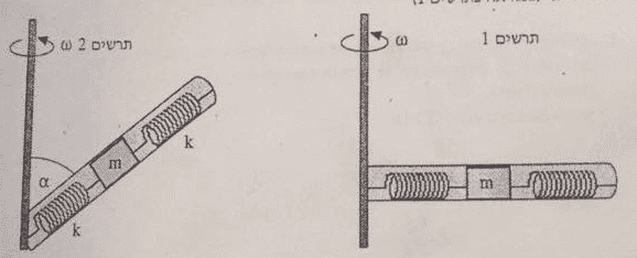

A body with a mass that equals to m is inside a smooth tube and is attached to two identical springs with constants that equal to k. Their length when they are limp is L0. When the body is in the middle of the tube both springs are limp.
The tube is attached to a pole that spins around with an angular velocity that equals to ω (The motion is only horizontal)
1. In what distance the body needs to be from the center of the tube so he will spin around along with the tube without moving in relative to him?
Answer: mω2L0/(2k-mω2)
2. Now we attach the tube in an angle of 37 degrees to the pole (α=37 degrees), what the angular velocity ω0 needs to be so both springs will remain limp?
2b. The angular velocity in increased to 2ω0, in what distance the body needs to be from the center of the tube so he will spin around along with the tube without moving in relative to him?
Honestly I tried a lot but I can't seem to solve the first question, can anyone help please?

I tried to say that the force that the springs enables on the body is 2KΔL, but it didn't work.

I said the left string enables a force that equals to kΔl=k(l0+x) (x is the distance from the center), then I said the right string enables a force that equals to kΔl2=k(l0-x), I also think both are in the same direction, but then they won't be equal to zero, if they are not and I want to check when they are equal I get an answer that is not even close. It looks like I am really missing something here, please, can you help?
First problem is that both of them won't be in same direction. Secondly you did not mention centrifugal force on the object.
The horizontal force on the object are :-
1) force by left spring that is toward the center of axis of rotation.
2) force by left spring that is away the center of axis of rotation.
3) centrifugal force (Find its direction)
Now can you equate them and get the answer ...

Obviously it will be toward the center, but I still don't get the right answer. The equation isn't mω2r+kΔl1-kΔl2=0 and Δl1=-x and Δl2=x?
Anyone?
yes, but what do you have for r there?

Obviously you are wrong, It is not towards the center, It is away from center.
Okay I understand that a centrifugal force will be directed away from the center, but when the force is centifugal and when it's centripetal? I was taught that the body is able to hae a circual motion thanks to the centripetal force, how there is a circual motion without it and how to know if the force is centrifugal or centripetal? We didn't discuss about this in class at and that's the last thing I don't understand here. Thanks in advance, you helped me a lot.
If the mass is displaced outwards, then both springs will apply a force on it inwards, creating the necessary centripetal force.

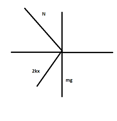

Okay, now I really need your help, I got a really long answer for 2b when the one in the book is very short.
You can't really see mg in the picture but those are the forces I used.
My equations were:
r=sinα(l0+x)
Nsinα=2kxcosα+mg
4mω02r=Ncosα+2kxsinα
Now I put numbers in my final answer for x and the answer value was the same as in the book, but in the book the answer is:x=3mgcosα/(2k-4mgl0cosα) and mine is very long. Are my forces and equations right? Thanks a lot.
Your FBD is not clear. I maybe missing something but where does that 2kx come from ?
From the springs.

Your equations look fine, but I do not know what you have for ω0. I cannot see a post where you finish answering 2a.
Now it hit me, I probably should use what I got in 2a. I am pretty sure it will be correct if you say the equations are fine. You all helped me to understand this topic much better, thank you all very much
