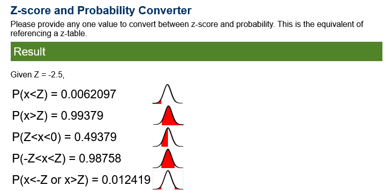

For your particular sample with a -2.5 z-score, you can use the website I gave to see what the probabilities of that (or more extreme) are, assuming that you are dealing with a normal distribution. For -2.5, it gives the results below. Keep in mind that if you have a lot of sample data, you are likely to see some extreme cases.

I am not sure what you are looking for. As @FactChecker mentioned the interpretation of a z score of -2.5 is that the data point is smaller than the mean by an amount equal to 2.5 times the standard deviation. For a normally distributed variable 98.8% of the values will be closer to the mean than that. There really isn’t any deeper interpretation.
