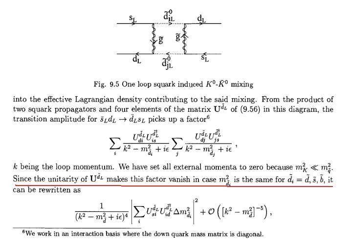

Well the context I'm talking about is the [itex]K^{0}-\bar{K}^{0}[/itex] mixing in SQCD... and more specifically the last equation in this attachment... Although I had another topic with that, I guess this topic is somewhat different... (see attachment for the next).
You have a susy contribution of the mixing diagram, which has two parameters I guess which you can tune to make this contribution small...
One is [itex]m_{d}[/itex] the universal squark mass... and the other is [itex]Δm_{i}[/itex] their difference... If I want the contribution to be small then I can either send very up high the universal mass of the squarks, or make very small their differences... (I don't think I could play with the [itex]U[/itex] matrices of flavor-mixing appearing from going to flavor eigenstates).
Is there any physical reason I can choose one out of these two?
One possibility is that I couldn't send to infinity the mass of squarks, otherwise the Higgs radiative corrections would "go crazy"... On the other hand I don't see why one could choose the mass differences to be very small... In quarks that's not the case, since their masses range from ~5MeV up to roughly 175GeV...

Be careful p-brane... When we are talking for SuSy and phenomenology, we are dealing with models (in this case MSSM)... Models can be ruled out by experiment... For example the Higgs mass at the moment is at extreme point of MSSM-SM predictions... if it was a bit higher, then MSSM would be ruled out because it cannot give the correct Higgs mass from its vev+ radiative corrections.
You can of course play with the model, but it turns out that you should have LSP at the TeV scale, otherwise then MSSM will be ruled out (otherwise SuSy won't be able to describe the gauge hierarchy problem that is one theoretical reason it exists).
For example I found 3 ways to deal with that problem...
1. Is to send the universal mass very large... at least for the first and second generation, since their yukawa couplings are small, and thus you don't get hierarchy problems... In that case all FCNCs loops are suppressed...
Also the prevention of large loop corrections of [itex]U(1)_{Y}[/itex] D-terms to the Higgs field then require the [itex]\sum_{i} Y_{i} m_{squark,i}^{2} < O(1TeV^{2})[/itex] - I don't really get this problem.
Another problem is when you implement such spectrum at high energies. In that case you have two loop contributions to the Renormalization Group equations due to [itex]SU(3)_{c}[/itex] interactions which tend to drive the stop quarks masses to negative values (thus charge+color symmetry breaking- isn't that weird? SU(3) breaking itself? also isn't it good for the matter-antimatter asymmetry?)
But this model also allows contraints on flavor conserving CP-violating amplitudes (eg from those yet unobserved magnetic dipole moments of neutron and electron) although soft susy terms contain violating CP phases of the order of unity.
2. Alignment between quarks and squarks mass matrix so that they both get diagonal in the same basis.
3. make the masses almost universal. In that case you can still have high amplitudes for FCNCs which are though suppressed by a super-GIM mechanism.
