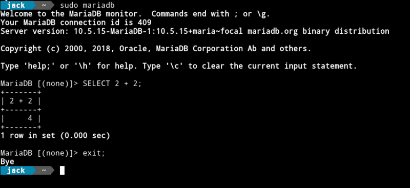

At the base, MySQL is just a program that manages databases. It can be used like any program from the command line. Following is an example on my computer (Linux) where:
  • I open MariaDB at the "jack" prompt (A program that branched out of MySQL; very similar);
  • The program gives a little introduction and presents a "MariaDB [(none)]" prompt;
  • I type the MariaDB command "SELECT 2 + 2;"';
  • The program responds with a table where the value "2 + 2" is given as "4";
  • The MariaDB prompt comes up again, where I choose to exit the program.
But the program is also designed to be used as a server, where it also listens to a TCP port as @DennisN mentioned in post #4. No need for the command line, a client can connect and send directly its requests, and wait for the responses. Whether the client is on your computer or somewhere else on the Internet is just a matter of who you give access to the TCP port in question.
A tool like MySQL Workbench (which is probably a MySQL client, using the TCP port?) will connect directly to MySQL and make the interaction with MySQL a lot easier than with the command line.
Was it necessary to use SUDO?

I don't use the command line version often, but only the root user has access to it on my personal computer. Maybe I could have logged in with a MariaDB user and password (which if I have, I don't remember).

Are you sure there isn't a server process running in the background, with the mariadb command being a command-line client program? That's how MySQL works on my Linux system. Here's an example similar to yours, where I use the mysql client as user jtbell to connect to the database music:

Now I open a second terminal window, get a list of all currently-running processes using the command ps -ef, and pipe the output to the grep command to select all lines that contain the string mysql:
Code:
jtbell@ubuntu:~$ ps -ef | grep mysql
mysql        968       1  0 12:25 ?        00:00:02 /usr/sbin/mysqld
jtbell      4483    2823  0 12:33 pts/0    00:00:00 mysql -u jtbell -p music
jtbell      4575    4517  0 12:33 pts/1    00:00:00 grep mysql
jtbell@ubuntu:~$
First you see the server program mysqld, running under user mysql. It started up automatically when I booted the Linux system. Then you see the client program mysql running under my user ID. Finally you see a process for the grep command.
Yes, I was simply running off the mysql user. I don't think you can use the MySQL "data manager program" without having a "server process" going on in the background (mine was /usr/sbin/mariadbd). My point was that you don't need an external client program to use MySQL.
The text in red in the following quote is what I was doing. But I'm not sure why I had to use sudo and I think it should be investigated, but it's not a high-priority problem right now on my personal computer.
https://mariadb.com/kb/en/running-mysqld-as-root/ said:
Running mysqld as root​
MariaDB should never normally be run as the system's root user (this is unrelated to the MariaDB root user). If it is, any user with the FILE privilege can create or modify any files on the server as root.
MariaDB will normally return the error Fatal error: Please read "Security" section of the manual to find out how to run mysqld as root! if you attempt to run mysqld as root. If you need to override this restriction for some reason, start mysqld with the user=root option.
Better practice, and the default in most situations, is to use a separate user, exclusively used for MariaDB. In most distributions, this user is called mysql.
No it wasn't, you are getting confused between the MariaDB (or MySQL) server daemon mariadbd (or mysqld) and the command line client which you run as mariadb or mysql - note mysql will probably work even if you are using the mariadb client!
There is never a good reason to run the server as root, however in order to do things like CREATE DATABASE on a MySQL/MariaDB install where there is no DB user with those priviliges (and there is no good reason to have a DB user with those privileges) you need to run the client as root.
You're right, I recheck the ps command with grep mariadb and I also have 2 other processes with the same STIME - sudo mariadb and mariadb - in addition to the server daemon (/usr/sbin/mariadbd). The user is of course root.
