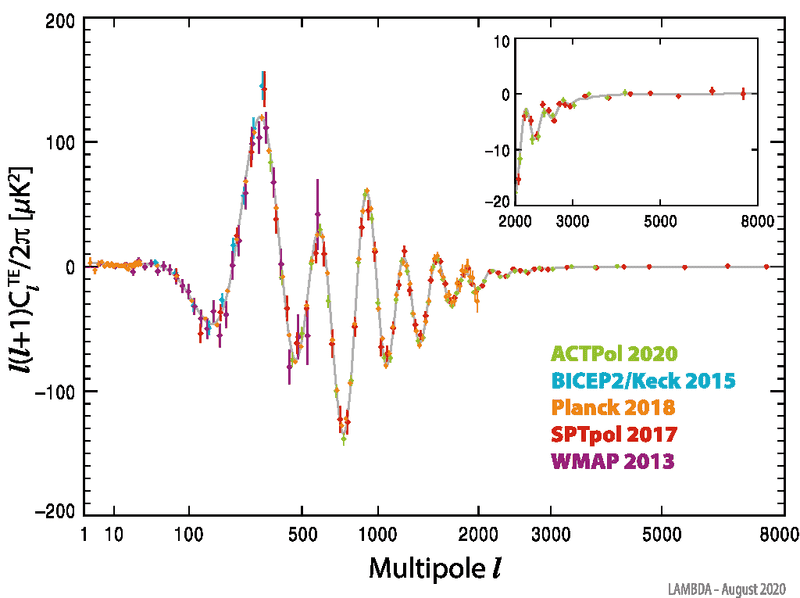

Does the polarization spectrum TE measured by the Planck and WMAP satellites show evidence for superhorizon fluctuations at low multipoles and are these evidence for pre-bigbang inflation?
According to Will Kinney, yes. Kinney is a professor of Physics at SUNY Buffalo.
In chapter 6 of his recent book (see below) he presents a figure of the TE cross-correlation power spectrum showing an anti-correlation at low multipole moments assigned as superhorizon modes. Unfortunately, no reference to the literature is given.
The actual power spectrum is from the Planck collaboration. I checked that, although I fail to recall from which of their many papers.
Will Kinney, An Infinity of Worlds: Cosmic Inflation and the Beginning of the Universe, The MIT Press, 2022.
To elaborate the comments made in Post #2. The TE cross-correlation power spectrum (courtesy of NASA/LAMBDA Archive Team) from the Planck mission is illustrated below:
It is the negative going peak in the power spectrum near ##\ell=100## that Kinney attributes to evidence consistent with superhorizon modes and thus with inflation.
