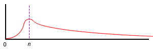

Is there a simple function that would produce a curve in this family?
Helping someone with some fictional physics.
He's looking for a function that will produce a curve similar to this (poor geometry is my doing, assume smooth curvature):
Starts at 0,0.
Maximum at n.
Reaches zero at infinity.
The cusp is not sharp, it's a curve (which, I think suggests at least two variables?).
Presumably, the curve is symmetrical about n logarithmically, but not a given.
The lognormal pdf curve matches the four criteria listed, as do a number of other right-skewed, long-tailed probability distributions (could try pareto, weibull).
It has two parameters ##\mu,\sigma## that can be adjusted to modify the shape.
To make the maximum (mode of the distribution) happen at ##x=n## we set a constraint:
$$n=\mu-\sigma^2$$

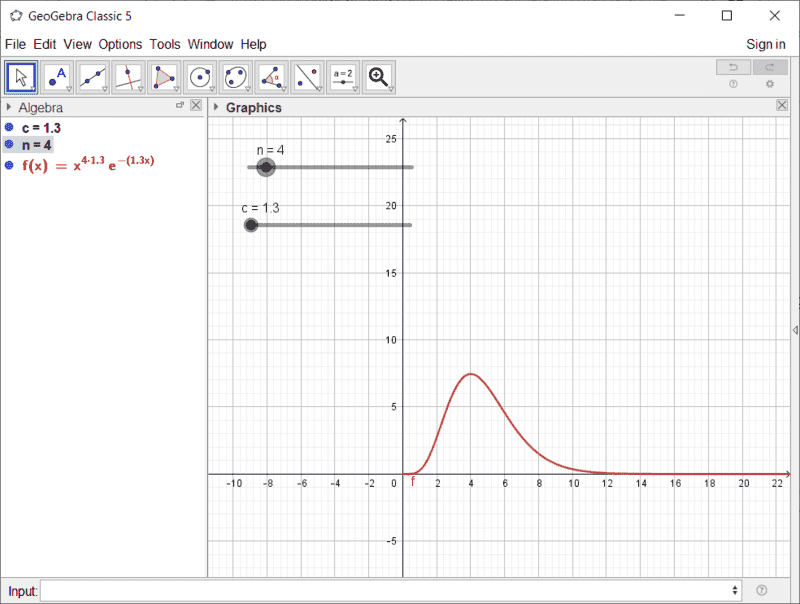

DaveC426913 said:
Thanks. What is c?
You should start with the fact that you want the peak to be at n. THIS IS NOT NECESSARILY THE n IN NBF'S POST. Using ##y= x^m e^{-cx}##, the peak is at ##m/c=n## (your ##n##). So you have a new function, ##y= x^{nc} e^{-cx}## with only the parameter, ##c##.
DaveC426913 said:
Also,where can I plug this into see it?
I like the free download of GeoGebra. It is easy to type in an equation and get a plot. In this case, you would want to first set up a parameter, c, and set the integer, n, to a value. Then define the function ##y= x^{nc} e^{-cx}##.
Here is an example.

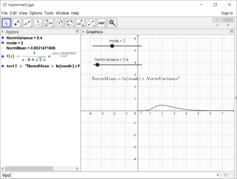

Here is a GeoGebra example of the lognormal method. Suppose you want the maximum value to be at n=2. That is the ##mean## of the lognormal distribution. So ##mean=2##. The lognormal has two parameters: ##NormMean## and ##NormVariance##. You can set the ##NormVariance \gt 0## parameter as you wish. The smaller you make it, the higher the maximum at n=2. The value of ##NormMean## is calculated as ##NormMean = ln(mode)+NormVariance^2##. With these parameters set, the lognormal PDF is determined. Here is the GeoGebra example.
