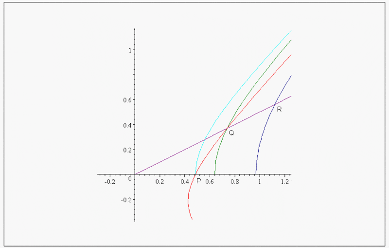

I have not calculated the acceleration for the second ship, but I am now able to plot worldlines of both ships. I might attach some .pdf plots in a later post.

To follow up on my [hopefully correct] formulation of the problem...
one set of curves that satisfies the "constant dot-product" condition is the set of spacelike rays from the vertex, which, as pointed out by Hurkyl, are the lines of simultaneity for those uniformly accelerating observers. Those rays, of course, don't count as worldlines... However, worldlines with unit tangents orthogonal to those spacelike rays should satisfy condition as well... but that's just the trivial case of the coincident observers again.
So, along these lines, one should tighten up the condition to read that the dot-products of their unit tangents be constant and positive (with the +--- signature convention) and that the dot-product of their spatial components doesn't change sign (to ensure that the velocities don't change direction... that is, same speed is not sufficient).
I'm beginning to wonder: is there a nontrivial solution? [Or is my formulation of the original problem incorrect?]
In spite of this, let me stick my neck out and make a guess at the answer... I don't have a lot of free time to check it out... but here it goes... maybe someone can prove or disprove it:
My conjecture:
The sought after worldlines are a spacetime-translation of the set of worldlines of our uniformly accelerating observers... probably with some restriction on the displacement between the vertices of their asymptotic lightcones. (The trivial case, of course, is zero displacement.)
Suppose the second ship crosses the (inertial) x-axis halfway bewteen the origin of the inertial coodinates and the place where the constant-acceleration ship crosses the x-axis, i.e, with inertial coodinates [itex]\left( 0,\frac{1}{2g}\right)[/itex]. Suppose further that the second ship moves through the accelerated reference frame [itex]\left( t' , x' \right)[/itex] such
[tex]x' = \frac{1}{2}t'+\alpha,[/tex]
where
[tex]\alpha = \frac{1}{2g} \ln \left( \frac{1}{4} \right).[/tex]
Denote the proper time of the second ship by [itex]T[/itex], so as not confuse it with the proper time [itex]\tau[/itex] of the first ship.
After the some calculation I get that the worldline of the second ship is given by
[tex]t \left( T \right) = \frac{2\sqrt{3}}{9}g^{2}T^{3}-\frac{\sqrt{3}}{8g^{2}}\frac{1}{T}[/tex]
[tex]x \left( T \right) = \frac{2\sqrt{3}}{9}g^{2}T^{3}+\frac{\sqrt{3}}{8g^{2}}\frac{1}{T}.[/tex]
for [itex]T>0[/itex].
This leads to (after calculation):
[itex]-4/T^2[/itex] for the square of the magnitude of the 4-acceleration;
[itex]2/\sqrt{3}[/itex] for the constant inner product of the appropriate 4-velocities (as it should be).
Regards,
George

I have attached an image of a plot of my results.
navy - ship accelerating at g
red - ship with constant speed 1/2 relative to navy
navy, green, blue - lines of constant distance in the acclerated frame
horizontal black, purple - lines of constant time (i.e., simultaneity) in the accelerated frame
Note that the tangent to navy at R is parallel to the tangent to green at Q, so what I a have said ("Let A and B be arbitrary event on navy's worldline. Draw a line simultaneity through A for an obsrever comoving with 1 at A. This line intersects 2's worldline at event A', say. Compute the relative speed by taking the inner product of the 4-velocities at A and A'. Now do the same for B and B'. The relative speeds should be the same.") is the same as what pervect and robphy have said ("Are you seeking a family of worldlines that intersect the above family of uniformly-accelerated worldlines such that the dot-products of their [unit] tangent vectors at these intersection events are constant?")

On my diagram, it appears plausible that red moves with speed 1/2 both at P (blue and black time and space axes), and at Q (green an purple time and space axes).

First a note about the diagram attached to post #18 - units on the time axis are years and on the space axis are lightyears, so g = 1.03/year.
