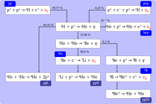

I was also able to find at https://en.wikipedia.org/wiki/Solar_neutrino the following diagram showing the chains of Solar reactions.
Can you tell me what the asterisk "*" means in the two boxes at the lower right attached to 8Be? My guess is that it means 8Be is radioactive.
Also, why in the lowest box is there no γ released in what seems to be a fission reaction?

The 7Be neutrinos come from 7Be decay via electron capture - ##e + ^7Be \rightarrow \nu_e + ^7Li##, which has a 90% branching ratio to 0.87 MeV, and a 10% branch to 0.39 MeV. The pep reaction comes from ##p+e+p \rightarrow d+ \nu_e ##. They're isolated vertical lines as the reactions are two body processes, rather than the rest, which are three body - e.g. ##^8B \rightarrow ^8Be + e^+ + \nu_e## - this is just energy/momentum conservation.
the "*" just indicates that ##^8Be## is populated in an excited state (technically you'd say it was in a resonant state, but that's beside the point)

1) A two body process is a reaction the produces only two output particles. This kind of process always produces a discrete rather than a continuous neutrino energy spectrum.
2) The excited 8Be* nucleus has either (a) exactly twice the energy of the 4He nucleus, or (b) a bit more than that. If (a), then the two 4He nuclei will move apart due to the repulsive force from their positive charges. If (b) then they will move apart somewhat faster to convert the extra energy available into kinetic energy. In either case, there is no residual energy to be carried away by a photon.

1. Yes. ETA: I mean "two body decay" here, rather than "two body reaction".
2. In essence, yes. For there to be a photon, you would either have to have 8Be de-excite via photon emission before breaking up (which won't happen fast enough, considering the lifetime of 8Be resonant states), or 4He be populated into an excited state which then decays via photon emission. There won't be the energy for this, and even then, excited states of 4He are above the proton emission threshold. The mass difference between 8Be and 2*4He is such that at minimum, the 4He particles will have 92 keV of relative energy (and some total kinetic energy depending on the kinetic energy of the 8B. If you put this all into the centrer-of-mass frame, the 8B is at rest). If you populate 8Be into the first resonant state (at 3.03 MeV) the alphas will have 3.03+0.092 MeV of relative energy. In the center-of-mass frame, the alphas will each have half the total energy.

No, I definitely meant proton. http://www.tunl.duke.edu/nucldata/figures/04figs/04_02_1992.gif

That is an energy level diagram, yes, but the units are in MeV, and the max state is not neccesarily the max state in principle, just the highest measured state.
The proton emission threshold is shown at 19.815 MeV, just to the left of the level diagram. This is the energy level at which 4He has enough energy to decay to 3H + p, rather than via gamma emission to the ground state.
This is relevant because there are two ways to get photon in this reaction - from 8Be or 4He. 8Be just doesn't last long enough for an EM process to occur (the lifetime of the 2+ and 4+ state are a fraction of a zeptosecond), which leaves us with 4He, now, even if you had the energy for it, 4He will decay via proton emission instead (or n or D for higher states).
Does this clear things up?

I think I almost get it now. If the 8Be -> 4He + 4He reaction produced an excied 4He nucleon with sufficient energy to emit a photon (20.21 MeV), it would instead emit a proton (or if sufficiently greater, something more massive).
Does it also mean that it is known experimentally that the above (8Be) reaction never does excites either of the two produced 4He nuclei to as much as 19.815 MeV since such a photon is never observed?

I don't know about experimentally (it's a well studied reaction, but I don't know off hand), but we can work this out pretty easily, there's no need for experiment:
Let's consider 8B decaying in it's rest frame.
The mass difference between 8B and 8Be is 17.98 MeV/c^2. So, at most you've got 17.98 MeV - Eelectron - Eneutrino of available excitation in 8Be. The alphas then have at most half of that + 0.092 MeV available for excitation (in their center of mass frame). Not enough to excite 4He. Hence my first comment about not having enough energy.

This was an answer to the question as to why a three particle emission resulted in a continuum spectrum. The post seems to have been deleted.

I was aware that in many reactions photons are emitted and I was currious about why they were not in the reaction I asked about,
Photons are emitted after electromagnetic interactions...or in some cases when excited nuclei are formed and transit to the ground state (again by electromagnetic interactions)...
In beta decays (or weak interactions) and strong interactions you don't have a photon emission.
