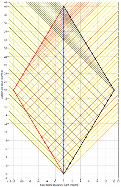

Hi all,
This is a follow-up to post 140 on April 9, 2013, the Triplets20.jpg of Triplet's Paradox.
First of all, fantastic diagram.
Is the following logic right as can be gleaned off that excellent diagram of Triplets20.jpg right?
Both ships turn around (earth proper time 20 months) and approach each for a long time before either ship knows the other ship has turned around. In fact, it won’t be until Earth proper time 35 that each ship realizes the other has turned around. In fact, when they do realize the other ship has turned around, and did so awhile ago, the Doppler shift will go very fast from red to blue, hitting all the colors in between in sequence.
In a sense, the answer to your question is yes, but it will really go from way beyond red to way beyond blue. However, when we are considering spacetime diagrams like this, we like to ignore those kinds of details because unless the observers on the ships have some sophisticated electronic equipment, they will never be able to see the other ships. We like to focus instead on the timing of the signals. Fortunately, the real problems in seeing such ships will never occur since there is no way we could enact this scenario for a multitude of physical reasons.

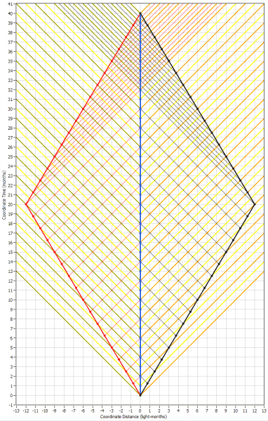

Here is the image re-uploaded:
Minkowski spacetime diagram with coordinate time in months on the vertical axis and coordinate distance in light-months on the horizontal axis, showing two worldlines forming a diamond with light-ray grid lines in yellow, orange, and red.
"way beyond red to way beyond blue". My guess is that, in reality, it could go from radio to gamma. I know red and blue are a very small sub-spectrum (less than 0.1%) of what humans see. Is this what was meant here? If so, I'm fine here because I know red and blue shift pertain to the zillions of colors humans can't see.
Is the sophisticated equipment needed to hit the remainder of the spectrum that is normally invisible to human eyes (outside the rainbow)? Is it just an issue of things happening not only in other colors (radio, gamma, etc) but the change-over from red to blue shift being too quick (micro, nano, etc. seconds on timescales too short too perceive) or something like that?
Yes, that is all correct.
That is all correct too.

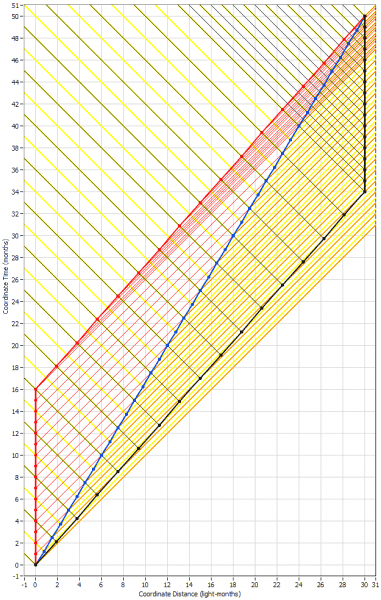

To illustrate, I'm going to upload another copy of the above IRF diagram but it will be a little smaller:
Spacetime diagram with Coordinate Distance (light-months) on the horizontal axis from -13 to 13 and Coordinate Time (months) on the vertical axis from 0 to 41. Two ships' worldlines form a diamond shape: a red line on the left and a black line on the right, with dots marking light signals between them, and a blue vertical line at distance 0.
I want you to notice the ratio of the thin black lines intersecting the red dots along the thick red line representing the ship that is on the left. For the first leg of the trip, there are 4 red dots per thin black line. This means that the Doppler ratio is 0.25. The red ship sees the black ship's timing as 1/4 of its own.
Then at the red ship's turnaround, at its Proper Time of 16 months, there is a one to one relationship between the black lines and the red dots which continues until the red ship's Proper Time of 28 months. At that time the red ship sees the black ship turn around and he begins to see the timing of the black ship at 4 times his own which continues until all three observers meet up again.
Now you might be tempted to think (at least I was) that if we transformed to the rest frame of the red ship during the second half of the trip, we would also see the black ship at rest during at least part of that time interval:

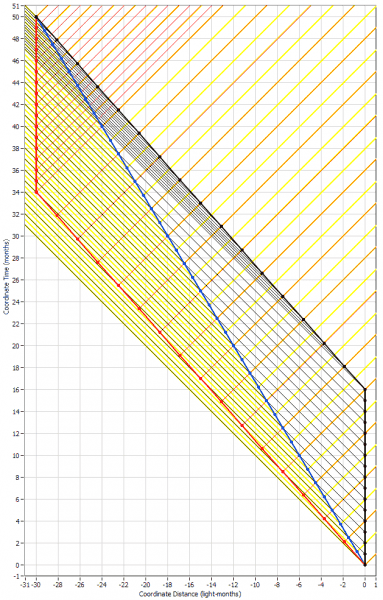

Finally, for completeness sake, here is the rest frame for the red ship during the first half of the trip:
Spacetime diagram with Coordinate Distance (light-months) on the horizontal axis and Coordinate Time (months) on the vertical axis, showing two ships' worldlines with red and blue Doppler-related grid lines and yellow light-ray lines.
Again, note the same Doppler ratios at the same Proper Times.
