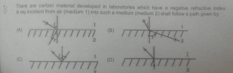

What is the relationship between critical angle and negative refractive index?
6 replies · 3K views · last reply
Tanishq Nandan
122
Four-option multiple-choice diagram (A to D) showing a light ray incident from medium 1 onto the boundary with medium 2, with the refracted or reflected ray drawn on each side of the normal.
[/B]
Snell's Law:
n1sin(i)=n2sin(r)
Critical angle=sininverse(n1/n2) [**only works when n2>n1]
If a light beam is incident at an interface of 2 mediums(with r.i n1 and n2) at an angle greater than the critical angle,the interface acts as a mirror,reflecting the entire beam.
I thought of it in terms of critical angle,and saw that according to the formula,critical angle's coming out to be some negative value.Doesn't this mean that any angle of incidence greater than that(which is practically every possible light ray) will have i>critical angle and undergo reflection??
So,I thought option C to be correct.
However,answer's A.
Help appreciated.

I know,I accounted for the given answer in the same way,but only after I had consulted the answer key.Before that,I was thinking about critical angles..and I still can't find the wrong in that.The only criterion for the formula,as I stated earlier,is n1>n2,which is obviously true since n2 is negative

OK, good point! But the condition for the existence of a critical angle would not be n1 > n2. I think it would be n1 > |n2|.
In this question, medium 1 is air. So n1 ≈ 1. Then, in order to have total reflection, you need |n2| < 1.
Some of the articles I found on the net mention materials with n2 = -0.3. So, this does satisfy |n2| < 1.
What would be the value of the critical angle in this case where n1 = 1.0 and n2 = -0.3?
So, you can see that for this case, answer C looks correct.
For n2 < -0.1, |θ2| is always less than θ1, and answer A would be correct.

But the question just says negative..and nothing about the value.I found your link interesting. .but a few(a lot,actually) of things looked kinda out of my league
Yes. So, it seems A or C could be correct. The only thing that I see that might dismiss C is that the angle of reflection does not look quite equal to the angle of incidence.
