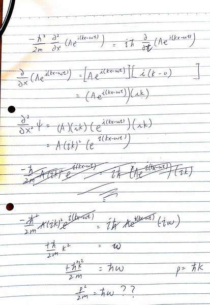

if the terms includes rest energy
i will not understand the Schrödinger equation
the Schrödinger equ
if the terms includes rest energy i will not understand the Schrödinger equation the Schrödinger equ for free particle
[PLAIN]http://hyperphysics.phy-astr.gsu.edu/%E2%80%8Chbase/quantum/imgqua/seq1.gif
for free particle U=0 and the second term is eliminated
and
http://hyperphysics.phy-astr.gsu.edu/%E2%80%8Chbase/quantum/imgqua/seq2.gif
sub ψ into the Schrödinger equ for free particle
and take the derivative
we got
(ħ^2)(k^2) / 2m = ħw
if E= homework = rel. energy
why can i get (ħ^2)(k^2) / 2m = ħw?
i mean, (ħ^2)(k^2) / 2m = p^2/2m where p is the momentum
and E will be equal to non-rel. KE energy only , but there is no rest energy included!
Plz help =(
STEPS are included
reference: Modern physics second edition , international ed, RANDY HARRIS p.110 - 112

Actually, i originally think that it refers to KE+rest energy , ie rel. energy
but what i get from the Schrödinger equation for free particles tells that E= non-rel. KE only
you can see the reply for more details. Plz help me, i spend a week to find the ans but i still can figure it out
