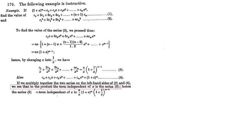

What is the solution to the Binomial Theorem problem highlighted in red?
Miike012
1,009
I highlighted the portion in red in the paint document that I'm not understanding.
How can we see by inspection that the product is equal to the series 2?
  • Scanned printed page of a binomial theorem example, example 176, showing expansions of (1+x)^n, series (1) and (2), derivations with n x (1+x)^(n-1), equations (3) and (4), and a red-boxed sentence about the term independent of x.
The term independent of x in the product is equal to the series (2); this is because the term independent of x is a sum of terms of the form [itex]kc_k x^k \times c_k/x^k = kc_k^2[/itex].
The second line in the paint document is equal to n/xn(1 + (2n-1)x + (2n-1)(2n-1)/2!x2 + ...) by using the binomial theorem
If we look at the coefficient of the second term it is equal to n(2n-1).
If we compare the coeff. n(2n -1) with the coeff. of the second term of series (2) which is
2c22 = 2(n-1)(n-2)/2! = n2 - 3n + 2 they are not equal.
Hence n(2n-1) =/= n2 - 3n + 2

Never mind I see that u said its the sum of the terms... I got it now
