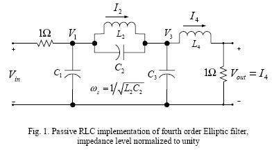

What is the transfer function for this 4th order elliptic filter circuit?
  • Thread starter pnjbi
    Filter
2 replies · 7K views · last reply
pnjbi
Hi,
I'm trying to find the transfer function to this circuit (see attached image). I put together a MATLAB script file which I will paste the code below. I found the transfer function to be:

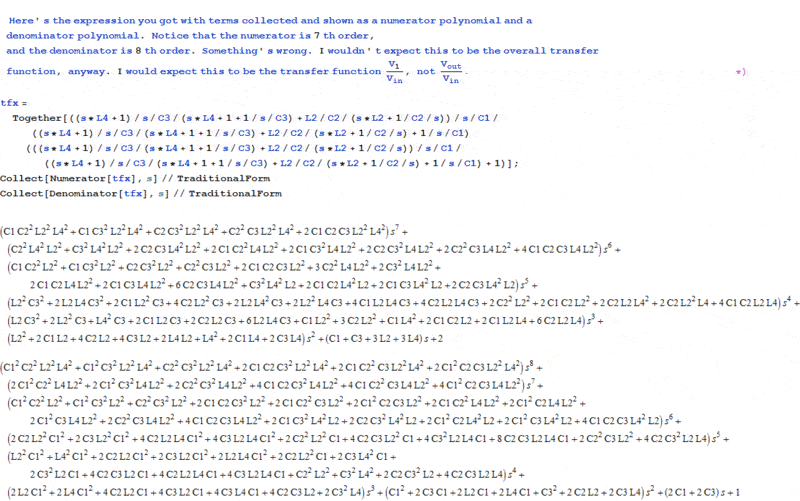

((s*L4+1)/s/C3/(s*L4+1+1/s/C3)+L2/C2/(s*L2+1/C2/s))/s/C1/((s*L4+1)/s/C3/(s*L4+1+1/s/C3)+L2/C2/(s*L2+1/C2/s)+1/s/C1)/(((s*L4+1)/s/C3/(s*L4+1+1/s/C3)+L2/C2/(s*L2+1/C2/s))/s/C1/((s*L4+1)/s/C3/(s*L4+1+1/s/C3)+L2/C2/(s*L2+1/C2/s)+1/s/C1)+1)
Can someone verify this is correct?
Matlab Code:

Thanks!

What you have done so far looks good, but you stopped too early. What you have called ZL is the driving point impedance at node V1. So when you calculated T=ZL/(ZL+R1), that is only the transfer function from Vin to V1.
Let T1 be what you have already calculated, and then using T1*Vin as the voltage at node V1, we need the voltage at node V2 = T2*V1 and the voltage at node Vout = T3*V2. So continue to calculate T2 = Zeq2/(Zeq2+Zeq3) and T3 = RL/(Zeq1). Then the overall transfer function should be T1*T2*T3.

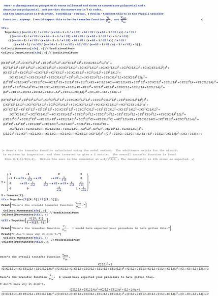

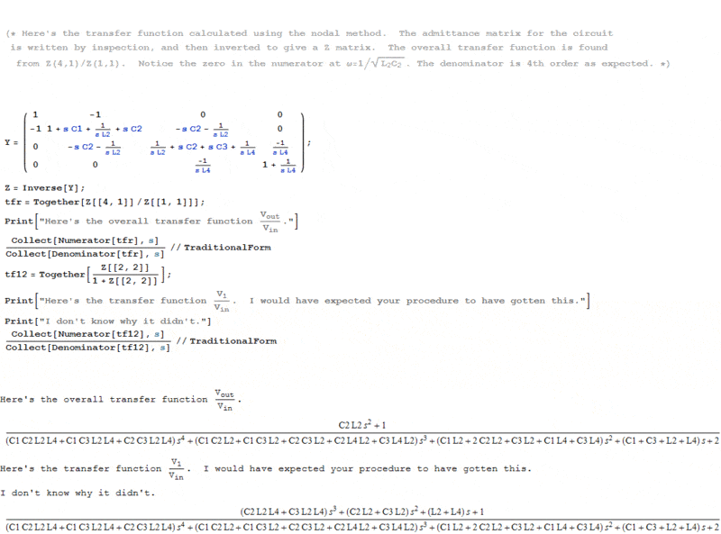

But, the calculations you have already done don't seem to have given a correct result, even though the steps in your MATLAB script file seem correct. I don't know matlab, so I've done it in Mathematica and attached the result as a .gif file. I typed in your expression and simplified it, and it didn't equal what I got.

I'm going to try posting the image in two parts. Hopefully it will be more readable.
  • Screenshot of a Mathematica notebook with blue comment text, a Together[] transfer-function expression in s, and expanded Numerator and Denominator polynomials in s, printed in traditional form.

  • Mathematica session showing a nodal admittance matrix Y with entries including sC1, sC2, sC3, 1/(sL2), 1/(sL4), and the inverse Z used to compute the transfer function Vout/Vin and V1/Vin, with the printed resulting rational expressions in s.
