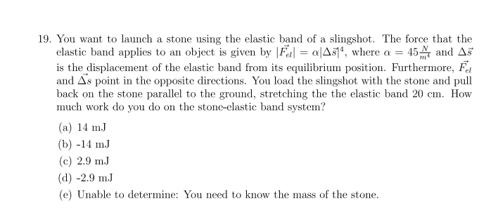

What is the work done on a slingshot?
Goofball Randy
The given elastic force equation
I plugged in the numbers, with 0.2m for the change in s and 45 for a. Since I knew that work was equal to force * distance, I multiplied that result by another 0.2m. This got me 0.0144J, or 14.4mJ. Since I knew that the slingshot was stretching in the direction you pull, the work had to be positive.
Unfortunately, my answer is incorrect. :(
Don't forget that work is the INTEGRAL of F dot dL, not just straight multiplication!
The force is not constant, the work can not be calculated by multiplying maximal displacement with maximal force.
Thanks guys! Seems really obvious now that I remember it.
