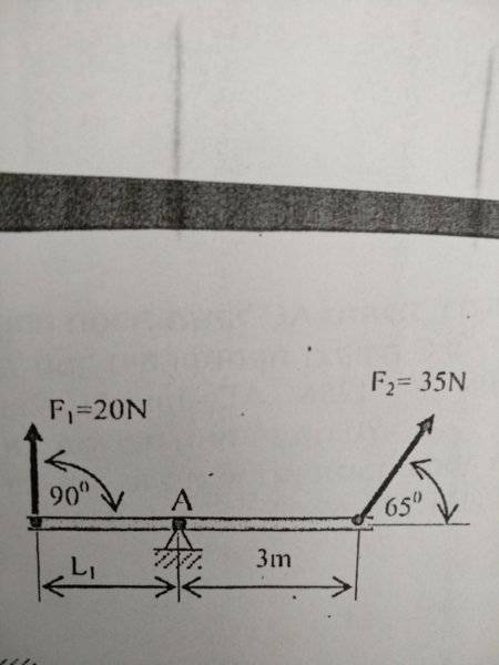

Hello
I need to find L1 length
but I don't know how to start

welcome to physics forum
you mentioned in the question it is statics what are the quantities that have to sum to zero for statics
The question says the system in the picture is in balance find L1 length .
That's it no more info in the question
no i was asking you

okay if something is balanced what needs to cancel out
Don't know
okay do you know about moments
I know that the formula says m=f*l
but how to proceed I'm not sure
Maybe. - fa*l + f2 *sin 65*3l
ok what is fa and what is f2 and why is there 3l
fa is force on point a (which I don't know)
F2 is 35 *sin 65 and 3l should be the distanceI'm totally lost here.
your method is correct but i think instead of 3l it should be 3 +L where l is what the question is asking
while this method is valid you don't know what fa is which you need to calculate separetely
what if you take moments about the point a

F2 (35 *(sin 65) * 3 (distance from point a to f2)
equal to 95.16 divide by f1 (20)
95.16/20 = 4.76 so L1 is 4.76 m
i think it is correct
do you know how to figure out fa and you might want to check your answer using that method
No I don't know how to figure fa
Use that the sum of all forces must equal zero in a static equilibrium.
I'm not sure if it's correct
Fx=0
Fa= F2(35)*cos (65) = 14.8
You calculated correctly (within a sign +- perhaps) the x-component of Fa. Now calculate the y-component of Fa.
