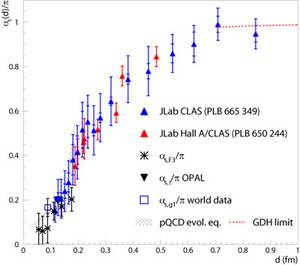

The strong coupling constant at large distances
I was referring to the quark-quark potential in e.g. quarkonia. That potential becomes constant at the "string breaking" scale.
