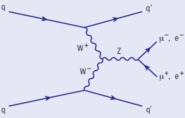

I disagree with "Only". Here is an example of pair production that does not involve electromagnetic energy:
Dear Hill
That image is about: "Z-boson production via weak-boson fusion"
https://cerncourier.com/a/first-observation-of-z-boson-production-via-weak-boson-fusion/
We discuss about electron creation from energy during pair production and not from any sort of q.
Therefore, this image is not relevant to our discussion.

davLev said:
Dear Hill
The "q" in the image stays for "quark". In this example, electron-positron pair is created from the energy of quarks and not from any electromagnetic energy.
Therefore, it is relevant to this discussion.
