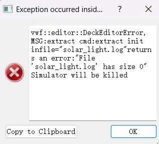

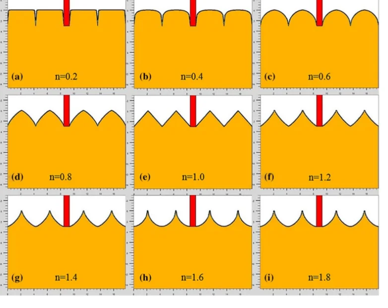

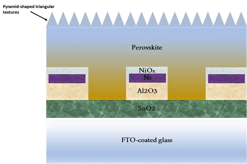

Hello everyone,
I am simulating back-contact perovskite solar cells (BC-PSCs) using Atlas. Now, I want to test my structure by adding pyramid-like textures (attached image as an example) on the top surface of the perovskite (absorber) layer using the etching command in Athena and analyze its performance. However, despite several attempts, I keep encountering errors when executing my code.
If anyone in the community has experience with this or suggestions, I would greatly appreciate your help.
Thank you!
You say you get errors executing your code. Sounds like the error is in there somewhere. I take it's not opensource though. :smile:
What specific errors do you encounter?
Thanks @sbrothy for responding. Could you please see the attachments. My code stop execution when reach to this point (extract init infile="solar_light.log") and the error (first attached image) pop up. I want to model and simulate structure as shown in the second attached image, no deposition etc., just etching of the top bare surface.

region num=1 user.material=CH3NH3PbI3 x.min=0 x.max=5 y.min=0.05 y.max=1.05
region num=2 material=air x.min=0 x.max=1 y.min=0.85 y.max=1.05
region num=3 material=air x.min=2 x.max=3 y.min=0.85 y.max=1.05
region num=4 material=air x.min=4 x.max=5 y.min=0.85 y.max=1.05
region num=5 user.material=NiOx x.min=0 x.max=1 y.min=0.85 y.max=0.95
region num=6 user.material=NiOx x.min=2 x.max=3 y.min=0.85 y.max=0.95
region num=7 user.material=NiOx x.min=4 x.max=5 y.min=0.85 y.max=0.95
region num=8 material=air x.min=0.05 x.max=0.95 y.min=0.9 y.max=0.95
region num=9 material=air x.min=2.05 x.max=2.95 y.min=0.9 y.max=0.95
region num=10 material=air x.min=4.05 x.max=4.95 y.min=0.9 y.max=0.95
region num=11 material=Nickel x.min=0.05 x.max=0.95 y.min=0.9 y.max=0.95
region num=12 material=Nickel x.min=2.05 x.max=2.95 y.min=0.9 y.max=0.95
region num=13 material=Nickel x.min=4.05 x.max=4.95 y.min=0.9 y.max=0.95
region num=14 material=Al2O3 x.min=0 x.max=1 y.min=0.95 y.max=1.05
region num=15 material=Al2O3 x.min=2 x.max=3 y.min=0.95 y.max=1.05
region num=16 material=Al2O3 x.min=4 x.max=5 y.min=0.95 y.max=1.05
region num=17 material=ZnO x.min=0 x.max=5 y.min=1.05 y.max=1.1
region num=18 user.material=FTO x.min=0 x.max=5 y.min=1.1 y.max=1.6
region num=19 user.material=glass x.min=0.0 x.max=5 y.min=1.6 y.max=1.63
electrode region=11 name=anode x.min=0.05 x.max=0.95 y.min=0.9 y.max=0.95 material=Nickel
electrode region=12 name=anode x.min=2.05 x.max=2.95 y.min=0.9 y.max=0.95 material=Nickel
electrode region=13 name=anode x.min=4.05 x.max=4.95 y.min=0.9 y.max=0.95 material=Nickel
electrode region=18 name=cathode x.min=0 x.max=5 y.min=1.1 y.max=1.6 material=FTO
extract name="Jsc" y.val from curve(v."anode", i."cathode") where x.val=0.0

@sbrothy I am using DeckBuild, which is a graphical user interface (GUI) that serves as a central platform for developing, debugging, and running simulation decks. The code/script needs to be written/pasted on which DeckBuild runs the simulations. So basically, the software is Silvaco, which has a GUI (DeckBuild). Silvaco has many tools for various purposes. In the context of solar cell simulations, the ones I am using are the Atlas and Athena tools of Silvaco. Atlas is used to simulate the solar cells' output parameters (Voc, Jsc, FF, PCE, etc.), whereas Athena is used for generating different shapes/structures.
The problem I am facing is the coupling of Athena and Atlas. You shared some groups, which I already joined; unfortunately, they didn't help me in this matter. The manual guide of Athena is a mess, specifically in the niche I am working on. By the way, thanks for your time!
