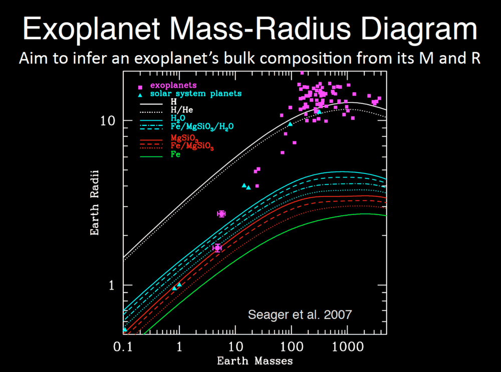

Look at the attached graph, from a presentation by Sarah Seager. Rocky planets follow the red lines. As they get more massive, they get denser because of the higher pressure. So any rocky planet more massive than the Earth will have a higher surface gravity than the Earth. So the answer to the question in the OP is "1 Earth mass". Unless the planet has different composition than the Earth (water rich for example, or without an iron core), in which case the answer can be different.

well, I'm wondering about the actually possibilities of such planets, hence I require real empirical data.
The graph I sent you is real empirical data, including solar system planets and exoplanets.

Look at the attached graph, from a presentation by Sarah Seager. Rocky planets follow the red lines. As they get more massive, they get denser because of the higher pressure. So any rocky planet more massive than the Earth will have a higher surface gravity than the Earth. So the answer to the question in the OP is "1 Earth mass". Unless the planet has different composition than the Earth (water rich for example, or without an iron core), in which case the answer can be different.View attachment 240648
Precisely.
"Rocky planet" would be one lacking an iron core.
Not unlikely. Moon does lack iron core.
In the attached plot, the exercise I referred to - numerical solving of compressibility for integrated mass, gravity, pressure - has been done for us.
It is a log-log plot. Therefore any power dependence falls on a straight line.
Find the upper right of the two triangles near mass 1, radius 1. It has mass and radius exactly 1, because it is Earth. The lower left triangle nearby is Venus.
Mark location at mass 100, radius 10. Near but not exactly at triangle which is Saturn.
Draw straight line between Earth, and mass 100/radius 10. All points on that line have exactly 1 g.
Then identify its intersection with the continuous red line, and read the mass there. You may need to enlarge the plot.

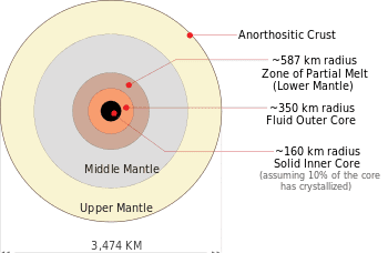

incorrect
"Core[edit]
Schematic illustration of the internal structure of the Moon​
Several lines of evidence imply that the lunar core is small, with a radius of about 350 km or less.[3] The size of the lunar core is only about 20% the size of the Moon itself, in contrast to about 50% as is the case for most other terrestrial bodies. The composition of the lunar core is not well constrained, but most believe that it is composed of metallic iron alloyed with a small amount of sulfur and nickel. Analyses of the Moon's time-variable rotations indicate that the core is at least partly molten.[4]
In 2010, a reanalysis of the old Apollo seismic data on the deep moonquakes using modern processing methods confirmed that the Moon has an iron rich core with a radius of 330 ± 20 km. The same reanalysis established that the solid inner core made of pure iron has the radius of 240 ± 10 km. The core is surrounded by the partially (10 to 30%) melted layer of the lower mantle with a radius of 480 ± 20 km (thickness ~150 km). These results imply that 40% of the core by volume has solidified. The density of the liquid outer core is about 5 g/cm3 and it could contain as much 6% sulfur by weight. The temperature in the "
