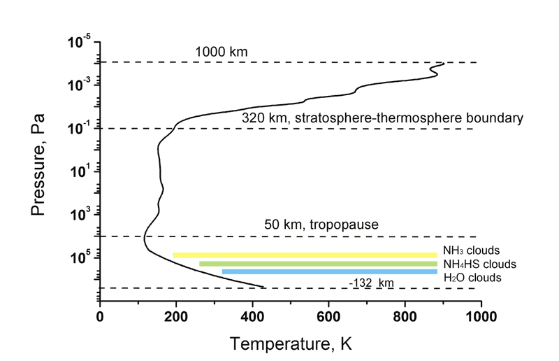

Because Jupiter's atmosphere (troposphere) gets warmer as you go lower. This is probably due to internal heat, not warming by the Sun. See the following graph from the galileo probe data.
I am still confused when the situation on Earth is compared with that on Jupiter to 'explain' the Methane clouds. The proportions of elements in the atmosphere (according to that Wiki article) is largely the same as in a star - mostly H and He. Everything else has much heavier molecules. H2O clouds in Earth's atmosphere seem quite reasonable as H2O vapour is less dense than our main atmospheric constituents. So water vapour can easily find itself high up in the Earth's atmosphere; it would just float up.
Is there some other mechanism - perhaps a lot of turbulence - that can cause molecules of methane to be present, right at the top the H layer? Methane molecules are 7.5 times the mass of H2 molecules. How can they 'float' up in any proportion? And what is it that keeps them up there in a layer with pretty stable looking forms (red spot etc.)?
I'v no doubt it's pretty complicated but it must be worth while resolving where intuition is going wrong. (I do believe the observations.)

I found a term "turbopause" which it the height above which simple diffusion governs the proportions of the gases. On Earth, it's at around 100km altitude and (of course) that's well above the clouds.
I think that has sorted my problem - thanks.
