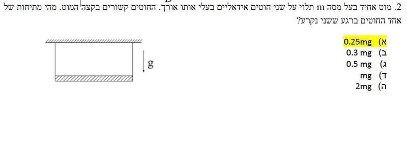

Rod with mass m depends on the two wires are ideal for the same length. Wires connected at the end of the rod. What is the tension in one of the wires as soon as the second string broke?
question options are:
0.25mg
03.mg
0.5mg
1mg
2mg

this problem at first looked quite easy, it's clear that before the broke each tension of wire is equel to 0.5mg. now i guess that after broke the rod is starting a circular motion, but i find it hard to relate it to the tension force. thanks in advance for any help !

Yes, after one of the string breaks, the rod accelerates due to the unbalanced torque acting about the pivot. What is the initial net torque about that pivot, and what equations are you familiar with that relates torque and acceleration?

You are confusing Torque with Moment of Inertia. The torque (or moment) of a force about a point is is equal to the product of the force times the perpendicular distance from the (cg of the ) force to that point. The Moment of Inertia of a thin rod that rotates about its end can be found with a web search.. Then you need to relate torque and I with the angular acceleration. And find the linear acceleration, and use Newton 2.

Let's go one step at a time. What is the torque about the pivot produced by the weight of the rod, assuming that its weight acts at the midpoint (center of gravity) of the rod? Express your answer in terms of m, g, and L, where L is the length of the rod. Remember that torque is force times perpendicular distance.

You must go by steps. You first need to find the Torque produced by the rod's weight. Again, what is the value of Torque that you find using Torque = Force times perpendicular distance (hint: the force is 'mg' and the perpendicular distance from the weight force from its center of gravity to the pivot is ____?

That is the sum of forces in the y direction, yes...you'll need this later...but first, you need to note the force which causes the torque (rotation) about the pivot point...that force, F, is just the weight of the rod...which is equal to ___? Then you get the torque, which is F times L/2 , and once you get the torque, solve for α, which is α = Torque/I, where I is ml^2/3. Thus, α = ___?
i think i got it, F=mg on the center of rod,
then: torque=mg*0.5L
then alpha = (0.5 * mg * L) / (0.5 * m * L^2)
means alpha = (1/L)

Yes, correct!

alpha = .5mgL/((mL^2)/3)
alpha = .5g/(L/3)
alpha = (g/2)/(L/3)
alpha = 3g/2L

Now that you have alpha, the angular acceleration, you want to find the linear acceleration of the center of mass, so you can use it in Newton's 2nd Law using the net force you calculated earlier in the y direction. So do you knw the basic equation that converts angular acceleration , alpha, into linear acceleroation, a?
that's a formula which i familiar with. alpha = a/r, means:
3g/2L = a/L, a= 3g/2
now i go back to coordinate y: tension-mg=ma, tension=m(g+a), tension=m*2.5g

You have missed 2 things...first, in your calculation for 'r', you used 'L'...but you are looking for the acceleration of the center of mass, which is not L units away at the tip, but rather______??
And second, the acceleration is initially vertically down, so which is greater, the tension in the rod or the weight of the rod??
sure, force works on the center of mass therefore r=0.5L
linear acceleration is with minus sign since it gets the rod down,
means: T=m(g-a)
a = alpha * 0.5L = 0.75g
then T=0.25g
