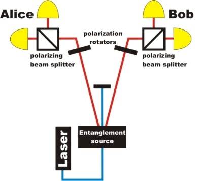

Typical Bell Test Setup
This is the typical setup for Bell test experiments, which can be performed in the undergraduate lab:
Schematic of a Bell test setup: a laser beam feeds an entanglement source, whose two output beams go to polarizing beam splitters for Alice (left) and Bob (right), with polarization rotators and yellow photon detectors at each output.
The yellow symbols are photon detectors
For additional info, watch this short movie on the basic setup for testing Bell inequalities:

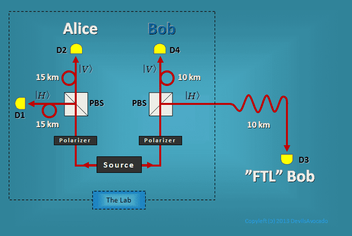

The EPR-Bell FTL Setup
Please don’t laugh. This will not work, but I’m just too ignorant to find out why. :smile:
Schematic of a two-photon polarization experiment: a central Source sends photons to polarizing beam splitters PBS for Alice and Bob, with detectors D1 to D4, 15 km and 10 km path labels, and a wavy 10 km link to a detector labeled FTL Bob.
There’s actually nothing strange about this setup. In fact it’s almost identical to the undergraduate lab setup, except for the extended (wind up & asymmetrical) optical fibers (red).
Bob is an old fashion guy, he always calls the cards first (10 km to detectors D3 & D4 vs. 15 km to detectors D1 & D2) and thereby imposing Alice a restricted “quantum freedom”, and in some cases like perfect correlation – she has no choice at all – if Bob get 1V Alice will get 1V as well.
Alice is deeply dissatisfied with current chauvinistic situation and has therefore forced Bob out of the lab – 10 km out in the wilderness – with only one detector D3 (i.e. a highly realistic quantum drama :smile:).
Despite these “quantum-drama-modifications”, the setup ought to generate exactly the same result as a standard Bell test in the undergraduate lab.
But the excitement doesn’t end here – Bob feels lonely & grumpy – and starts disconnecting detector D3 every now and then, to let photon B pass without any detection. Payback time!
The Big Question
What will Alice see in the lab? Will she notice anything? My claim is that she will definitely get the message – there’s a “Bob Revolution” going on out there in the wilderness.
Why??
Well, let’s do the math. In the setup we use a SPDC Type I down converter that along orthogonal axes will always result in the same outcome (i.e. perfect correlation).
Let’s assume we measure 100 entangled photons with a 90° relative angle between Alice & Bob:
sin^2(90°) = 100% = 100 correlated matches, i.e. [1V, 1V] or [1H, 1H]
We derive the result from:
  • 50% of the time photon B is detected at D4 and Alice will then detect photon A at D2.
  • 50% of the time photon B is not detected at D4 and Alice will then detect photon A at D1 (and we assume Bob detected photon B at D3).
If Bob decides to disconnect detector D3 before measurement, we get:
  • 50% of the time photon B is not detected at all.
  • When photon B is not detected, Alice measurement will be 100% random, i.e. 50/50 chance for photon A to be measured as [itex]\left|H\right\rangle[/itex] or [itex]\left|V\right\rangle[/itex].
And we get:
sin^2(90°) = 100% x 50 = 50 correlated matches
+ 50% x 50 = 25 = A total of 75 matches
This is clearly enough to confirm there’s a “Bob Revolution” going on 10 km out in the wilderness.
(In fact, as soon as Alice detects A at D2 and B is not detected at D4 we know something is going on.)
Where’s FTL!?
Well, once we established that Bob could use his detector D3 to signal a change to the lab 10 km away, it’s easy to build a system for Morse code, or better, a binary transmitter. In the movie above on the undergraduate lab we get 500 entangled measurements per second. If 100 photons is enough to confirm that Bob did a change, that mean we could send 5 bit/s.
Ha, 5 bit/s! Grandpa’s bicycle is faster!
True, but the communication is instantaneous. Change km to ly and it will definitely be FTL.

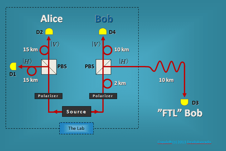

Are you sure about the ordering? If we rig the setup to be asymmetrical when it comes to the apparatus having an influence on the shared wavefunction – are we not allowed to say that one thing happen before the other (since photons A & B travels at c)??

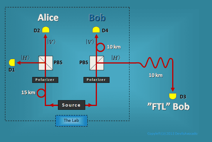

And in this case, what happens in the setup below. If the PBS is the one “making the decision”, photon A will be there first, but photon B will nevertheless be measured first?
How is one supposed to handle this...?? :rolleyes:
Schematic of an EPR-Bell experiment with a central Source, two polarizing beam splitters (PBS) and polarizers, detectors D1 to D4, and a 10 km path to a detector D3 labelled FTL Bob, with fiber lengths of 15 km, 10 km and 2 km marked.
This is a thorny question: is the wave function split/collapsed at the PBS or not? There are interpretations both ways. But I think the fact that the PBS outputs can be re-merged (restoring entanglement, presumably) tips the scales in favor of NO.
Imagine there was no PBS on Bob's side, and Alice sees a click at D1. What is the polarization of Bob? :smile: It must be H>. That is the EPR conclusion. So the PBS on the right is superfluous. Of course, the same is true vice versa. So go figure.
The usual view is: you must look at the entire context of a measurement to properly estimate the results. Ordering definitely does not matter, and there are no relativistic effects to consider here.

This was unexpectedly quick. I was drinking coffee it just struck me that there might be a way to tie up some loose ends a bit:
Diagram of an EPR-Bell style setup: a central Source sends entangled photons to Alice's and Bob's polarizing beam splitters (PBS), each with a polarizer and detectors D1, D2 and D4, with a third detector D3 reached by a 10 km path labelled FTL Bob, and fibre loops marked 15 km and 10 km.
In this setup old Bob owns the game. :smile: No matter what we are talking about, PBS or else, Bob will be done a long time before (5 km ≈ 16.5 µs) Alice’s photon A has chance to do any choice.
Now, the question remains if the PBS qualifies as a measurement (in case of D3 disconnected), and I think there might be a chance to figure this out as well...
We let Bob’s polarizer stay fixed and start rotating Alice’s polarizer.
Now, when photon A enters the PBS it has to obey the predictions of QM + Bob’s result. If we get a sinusoidal curve with D3 disconnected, somehow Bob’s PBS (+ D4) is enough information for photon A to know what to do. Otherwise we get no sinusoidal.
I don’t know... something tells me there will be no sinusoidal with D3 disconnected... how on Earth is photon A going to know that D4 did not register and therefore it has to act as if D3 did...??
The only information available to A should be the status of shared wavefunction.
Or, I’m totally wrong... weird...

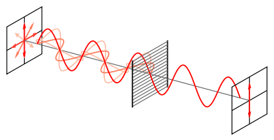

When we run ‘normal’ unpolarized light thru a polarizer, it’s a no-brainer to understand what happens:
Diagram of a photon traveling left to right, with red transverse oscillations and red polarization arrows: unpolarized arrows at the left, a grid of vertical wire lines in the middle, and vertical arrows at the right.
50% of the unpolarized light gets thru, and it doesn’t matter what angle we set.
