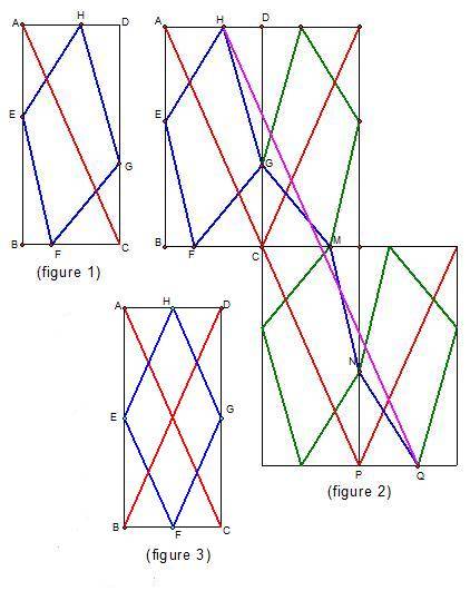

Rectangle ABCD ,having fours points$ E,F,G,H $ located on segments AB, BC, CD,and
DA respectively , please prove :
$EF+FG+GH+HE\geq 2 AC $
and determine when the equivalence can be taken ?
Re: Ef+fg+gh+he>=2ac
suppose we have another three cards equivalent to figure 1 ,and rearranging these four cards
in a position as shown in figure 2
from figure 2 we see :2AC=AP=HQ< HG+GM+MN+NQ=EF+FG+GH+HE
figure 3 shows the equivalence will be taken when E,F,G,H are midpoints of AB,BC,CD,and DA respectively
2AC=AC+BD=EF+FG+GH+HE
  • Three rectangle diagrams with inscribed quadrilaterals EFGH and diagonals in red and blue; figure 2 shows four such rectangles tiled with points P and Q labelled.
