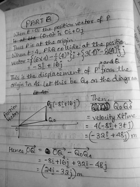

I'm self-studying for my Edexcel Mechanics 2 GCE A Level exam (it's in 10 days :S) and was having lots of trouble with one of the kinematics questions. I've uploaded photos of the problem and my solution for part (a) of the question. I couldn't use the math notation feature on the Physics Forum properly; I hope the photos aren't a problem for anyone!

Hi RoyalCat :) Thank-you for your help. I'm guessing my book is wrong, unless someone else shows us otherwise? :) I've finally come up with something for part B. My answer of (24i - 32j)m for the position vector of Q with respect to O when t=0 doesn't match the book's answer of (24i - 8j)m.
Here's my working out:
Is my book wrong here as well? This is my examining body's (Edexcel) new and revised official coursebook for the Mechanics 2 exam :S :S
The book is right on this one, though.
The velocity of Q is not constant. It is a function of time.
The difference in position must be found by integration.
One approach is to take the indefinite integral, and set two constants for the initial x and y positions, which must then be found using the boundary conditions (The position at time t=4 sec is known).
Thank-you so much for your hints RoyalCat :) My answer finally matches the book's one:
Position vector of Q
= Integrating the velocity of Q
= (-8t + a)i + [(3/2)t^2 + b]j
As P and Q collide when t = 4, the position vector of Q = position vector of P at that time
Hence, position vector of Q when t = 4: -8i + 16j {worked this out in my first attempt at part B, above}
So,
-8t + a = -8
So, a = 24
And, (3/2)t^2 + b = 16
So, b = -8
Hence, position vector of Q = (-8t + 24)i + [(3/2)t^2 - 8]j
Therefore, when t = 0
Position vector of Q = 24i - 8j (The answer ^_^)
