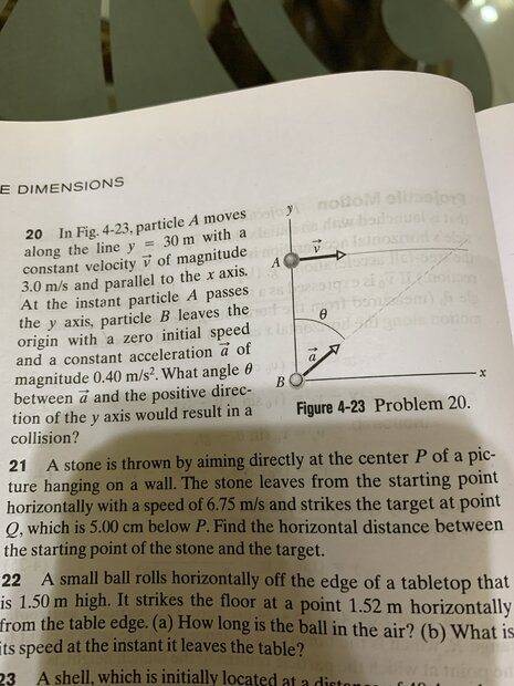

In fig, particle A moves along the line y=30m with a constant v= 3m/s parallel to x. At the instant particle A leaves the y axis particle B leaves origin with zero initial speed and constant acceleration a =0.4 m/s^2. Find theta

It will help, if you could please create a drawing that shows both particles on the x-y axis, or at least include it here if it is given. I will assume that θ is the angle of the particle B with respect to the x or y axis. However, this angle could really take any value based only on your provided data. I will assume that the particles will meet at some time t, but you will need to specify they will meet, otherwise it is impossible to say what is θ.

If you refer to the diagram in Post#1, you will see that ##\theta## is defined as the angle relative to the y-axis. I think you have incorrectly treated it as the angle relative to the x-axis.
