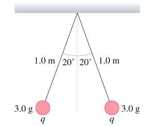

Two 3.0g spheres on 1.0m-long threads repel each other after being equally charged, as shown in the figure.
F = k*q1*q2/r2
sin 70° = Ty/T
T = (m*g)/sin 70°
T = 0.003*9.81/sin 70°
T = 0.03132 N
Tx = T*cos 70°
Tx = (0.03132)*cos 70°
Tx = 0.01071 N
Since both objects experience this force, the force is doubled at 0.02142 N.
1/2*r = sin 20°
r = 0.6840 m
T2x = k*q2/r2
q = (T2x*r2/k)1/2
q = [(0.02142)(0.6840)2/(8.99*109)]1/2
q = 1056 nC = 1.056* 10-6 C
Where am I going wrong?

I suggest that the line in red is where you went wrong.
during a "tug-of-war", when two teams pull on each end of a sturdy rope, each team pulls with the same force [Newton's third law will show why the forces are equal] but the tension in the rope is just that same value. ie. if each team pulls with 10 000 N, the tension in the rope is 10 000 N [not 20 000 N]
sin 70° = Ty/T
T = (m*g)/sin 70°
T = 0.03132 N
Tx = T*cos 70°
Tx = 0.01071 N
1/2*r = sin 20°
r = 0.6840 m
Tx = k*q2/r2
q = (Tx*r2/k)1/2
q = [(0.01071)(0.6840)2/(8.99*109)]1/2
q = 747 nC = 7.47* 10-7 C
How about now?
Got it, thanks guys. :)
(747 nC is correct).
