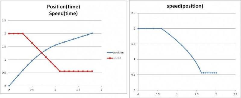

If you slow a cart with a constant acceleration, the speed decreases linearly with time (so at a constant rate, as you say). The distance covered has something like ##x(t) = x(t_0) + v(t_0) t + {1\over 2} a t^2 ## with a < 0. so v as a function of position might just have a square root in it. Not really nice, but you don't have to calculate it: it's sufficient to know that the speed decreases monotonically with distance. Obviously the average speed is maximum if the slowing down starts as late (far to the right) as possible.
Example with felt at 0.6 m , v0 = 2 m/s and devceleration on felt -1.8 m/s2 :

You certainly are making sense ! If we look back to the picture in post #5: there is a section with ##v_0##, then a section where ##v## drops, and finally a section where ##v## is constant again, but less than ##v_0##. It is evident that the average speed is maximum if the section where the speed drops off is shifted tothe right as much as possible.
All my bla was just to point out that on the mat the speed drops off linearly with time , but not linearly when considered as a function of x on the v(x) plot.
And I considered the exercise as a maximization problem for v(x) in the range 0 < x < 2 m. However, the exact shape of the v(x) on the mat is not relevant for the outcome; but the position on the x-axis is the deciding quantity for achieving the maximum $$ \ \ v_{\rm average} \equiv { \int_0^2 v(x) dx \over \int_0^2 dx} \\ \mathstrut $$

Well, if I work out the vaverage expression (let the mat start at ##x_1## and the speed at the end of the mat be ##v_1##) :$$
\quad = {1\over 2} \left ( \int_0^{x_1} v_0 dx + \int_{x_1}^{x_1 + 1 } v(x) dx + \int_{x_1+1}^{2} v_1 dx \ \right ) \\
\quad = {1\over 2} \left (v_0 \int_0^{x_1} dx + {\rm some \ constant} + v_1 \int_{x_1+1}^{2} dx \ \right )\\
\quad = {1\over 2} \left (v_0 x_1 + {\rm some \ constant} + v_1 (2-x_1) \ \right )\\
\quad = {1\over 2} \left ( (v_0 - v_1) x_1 + {\rm some \ constant} + 2 v_1 \ \right ) \\
\quad = a x_1 + b
$$ with a and b constants. No need to differentiate wrt ##x_1## because this is increasing linearly with x, so the biggest x possible gives the maximum.
