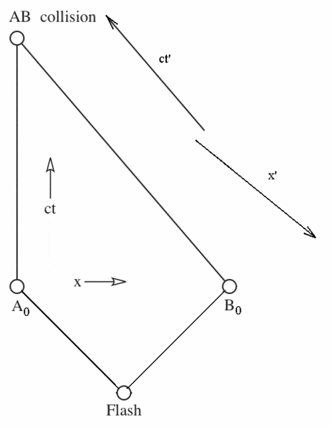

OK, here is your first problem. The spacetime diagrams are not triangles, they are quadrilaterals. There are four events of interest.
1. the flash of light
2. clock A receives the flash (and is set to 0)
3. clock B receives the flash (and is set to 0)
4. clock A and B collide (and read out their times)
This is equivalent to my system of two spacetime diagrams drawn using flash of the light to be the start point, and putting the stationary observer at origin.

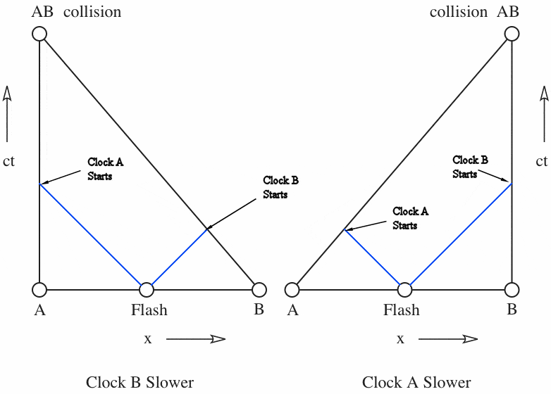

Well, then see the attached gif.
  • Two spacetime diagrams with axes ct (vertical) and x (horizontal). Left, labelled Clock B Slower: A and B at the base with Flash between them, and a diagonal line from A up to B, meeting at AB collision. Right, labelled Clock A Slower: A and B at the base with Flash between them, and a diagonal line from A up to AB collision above B.

May be I am too bad at drawing diagrams, however, the midway point between A and B, which is labeled "Flash" is light flash.
The time for light signals to travel to the clocks is ignored (which does not make any difference to the situation I suppose), because the clocks starts after the signal reaching them, so anything before that is irrelevant.

It does make a difference. If the flash occurs at a point a point that is truly midway between A and B (in A's frame) then A and B will not be equidistant from the flash when the signal arrives at A and B. If you would like to draw a more accurate version of your initial diagram that includes the light signals just draw the light signals as lines that are 45 degrees from the vertical t axis while all physicals objects travel on lines that are less than 45 degrees from the t axis. This is true in any frame.
For every event with coordinates (x,t) in A's frame there should be a corresponding event (x',t') in B's frame where x' and t' are defined by the Lorentz Transformation

And herein is your mistake. Because the time it takes for the light signals to travel cannot be ignored because It doesn't take an equal amount of time for the light to travel from emission point to A and B, according to A or B. Each determines that the flash reached the other before them.
Heres an modified attachment of your diagram showing the travel of the light flash(in blue). Light paths in space time diagrams follow 45° angles. Maybe it will clear things up for you.
  • Two space-time diagrams labelled Clock B Slower and Clock A Slower, each showing points A, Flash and B on the x axis and ct on the vertical axis, with black collision lines and blue light paths at 45 degrees.

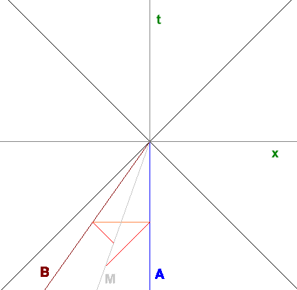

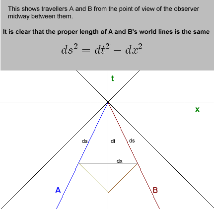

Space time diagrams
Here is my attempt to draw the space time diagram for the observer midway between A and B. Where did I go wrong ?
  • Minkowski space-time diagram with t axis vertical and x axis horizontal, showing worldlines of travellers A and B meeting at the origin, with ds and dt labels and a dx segment; gray box contains text and the equation ds^2 = dt^2 - dx^2.
Thank you kev for your suggestion and Janus for pointing out my mistake and revising my diagram...
All said and done, the original question is still unanswered. Which will be the slower clock? We are stressing upon the method of setting both clocks at zero, which may be any arbitrary method. But what after that? As is now clear from revised diagrams, the equidistant light flash can't work. Let's say then that there was some other non-equidistant flash that set them zero. Which clock will be slower then? Let the flesh be from such a distance so that the light travels same distance to reach clocks A and B. It's settled now I suppose.
Or is it impossible to set both clocks read zero? It doesn't seem impossible!
And even in the revised diagrams, from both point of views, the other clock is slower. How to decide which clock is slower? Or should we say the clock which is "really" moving is slower? But we have no way to decide which clock is moving!
Further, If at all any clock is slower, the collision should not happen, because, due to different time co-ordinates, clocks A and B will reach the collision point at different instants.

I depends who is asking. If A and B merely pass very close and observe one and others clocks, each will see the other clock slower. If they pass an observer located at the midpoint between them, she will see their clocks as the same. They can all disagree happily and there is no problem.
However if A and B are brought to rest at the midpoint, then they will compare clocks and find the same elapsed time provided they used identical procedures for stopping.

Regarding my earlier post, I see now that it correct, because the midpoint observer sees the same time on both clocks as they pass.

When the clocks meet they will read the same time according to all frames. They collision point at the same instant in all frames, and thus collide in all frames. What will differ form frame to frame is how fast each clock ran and when it started. In a frame where one clock ran slower, it will have also started sooner.

A and B's clocks would be slower compared with one left at the midpoint and synchronised with the light flash.
Don't confuse the two stuations
1. observing a moving clock ( it runs slower) depends on relative velocity.
2. round trip setup, where two clocks are together, travel separately and then meet. Depends on trip proper length, and is real ( verified by experiment).

How is it possible for both clocks to accumulate same time, when at least one of them was moving before it stopped?
To determine how much time each clock accumulates, you have to take into account:
1) When did it start running?
2) At what rate did it tick while running.
3) When did it stop running?
Since we are comparing two clocks, we can figure that above as seen by each clock.
Thus for A and B considered from their own reference they start at a certain time reading 0, run at a certain rate and stop at a certain time reading time "t"
But what of B as seen from A, and A as seen from B.
A sees B start at some time before A itself starts(IOW, by the time A itself starts ticking clock B has already built up a "head start"), then tick at a slower rate than A, and then stop at the same time as A (when they collide), at which time it will read the same (t) as Clock A(by ticking faster, A closes the gap of B's head start). So even though clock B ticked slower than A while running, it started ticking before A, and thus accumulates the same time as A between starting and stopping.
B sees the same thing with A and B switched.
Hi Antigen, Sorry about the delay, had a picnic to attend :smile:. I see that the conversation has run away a little. I will try to rewind a bit and go step-by-step.
Your first spacetime diagram was pretty close. I corrected it so that the speed of light from the flash was not infinite! The other thing that I did was to add the ct' and x' axes representing coordinates in the other frame.
Before we go on to the diagram in the other frame, do you understand my additions/changes to this diagram? Do you disagree with any of the changes?
  • Spacetime diagram with ct vertical and x horizontal, showing a flash at the bottom meeting worldlines A0 and B0 that rise to an AB collision at the top, with a tilted ct' and x' coordinate pair.

I had read and reread all the posts (Janus's posts more carefully), but can't see how is my question answered. Can you point out precisely?
Again situation restated, from the frame of the origin of light flash both clocks started at zero time "simultaneously". The observer in this frame obviously knows that A is stationary and B is moving wrt him. Now, after collision, he brings the stopped clocks and compares times. According to Janus's post and Mentz114's spacetime diagram, he finds that both stopped clocks have accumulated same time.
Now, as the observer in light-flash frame knows that B was moving while A was stationary, thus B should have accumulated less time, for the same reason we say time dilation is real and not apparent. clocks actually slow when moving which is experimentally tested as has been pointed out earlier. Then how come we say that the light-flash frame observer (or any other observer because the clocks had been stopped earlier) would see the same accumulated time? where is the time dilation?
I Do agree.
