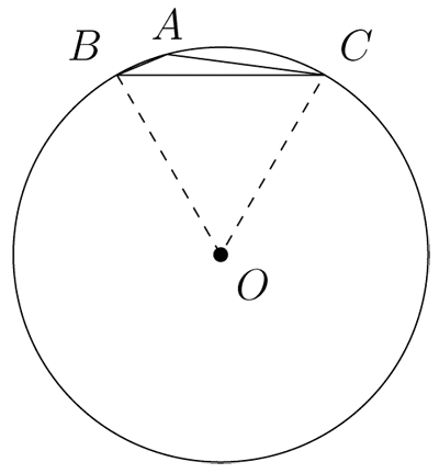

If $\Delta$ is the area of the triangle then $\Delta = \frac12bc\sin A$ and so $\sin A = \frac{2\Delta}{bc}$, and similarly $\sin B = \frac{2\Delta}{ca}$ and $\sin C = \frac{2\Delta}{ab}$. The inequality $\sin A + \sin B + \sin C \leqslant 1$ then becomes $2\Delta(a+b+c) \leqslant abc.$ But (see here for example) $abc = 4R\Delta$, where $R$ is the radius of the circumcircle. Therefore $2\Delta(a+b+c) \leqslant 4R\Delta$, or $s\leqslant R$, where $s = \frac12(a+b+c)$ is the semi-perimeter of the triangle. In particular, we must have $a\leqslant R$, where $a = |BC|$ is the longest side. It follows that the angle $BOC$ in the diagram below ($O$ being the centre of the circumcircle) must be at most $\pi/3$, and hence the angle $A$ must be at least $5\pi/6$. Therefore $\sin A \leqslant \frac12.$

Opalg said:
... $a\leqslant R$, where $a = |BC|$ is the longest side.
Sorry if this is obvious but I can't quite follow this. How do you get $a\leq R$? Why not $a\leq 2R$? :confused:
$a$ must be less than $s$ because $a\leqslant b+c$ (any side of a triangle must be less than half the perimeter, because the sum of the other two sides is larger then it). So $a = \frac12(a+a) \leqslant \frac12(a+b+c) = s \leqslant R.$

Pranav said:
And I am still stuck at Opalg's post. I understand how $a\leq R$. When a=R, I see that A is $5\pi /6$. I don't see how A=$\pi/6$ is achieved. :(
Given that $a\leqslant R$, it follows that either $A\geqslant 5\pi/6$ or $A\leqslant \pi/6$. But $A$ is supposed to be the greatest angle in the triangle, so it cannot be $< \pi/6$. If the greatest angle in the triangle is $\pi/6$ then the triangle would have to be equilateral, in which case $\sin A + \sin B + \sin C = 3\sqrt3/2 >1$, so we can certainly rule out that case.
