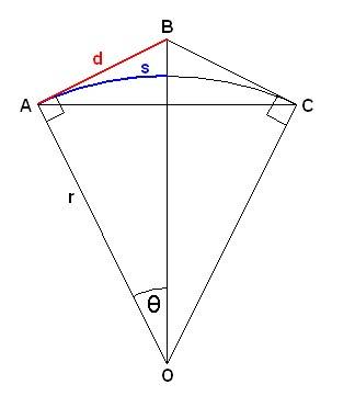

For what its worth-- this is as close as I can find for a general proof:
This is a general arc-corner scenario. By symmetry, we need to only consider s and d--need to show that s < d.
The formula for arclength is s = (θ in radians).
Applying that formula, need to show that < d:
Re-organizing: θ < d/r
Note: tan(θ) = d/r
If θ < tan(θ), then proven (which it is over the interval 0 < θ < pi/2 ).
