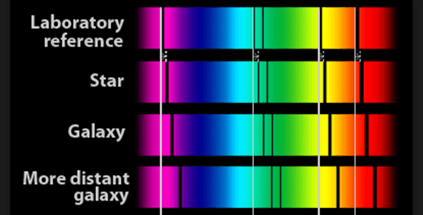

Thanks. That is my bad drawing of the textbook question - all the lines in A shift to the right by the same amount. So after what we discussed this diagram I found on the internet must be wrong:
In this diagram the original spacing between spectral lines in the reference frame is maintained but if I am understanding things correctly the spacing must increase because of the " + λreference" term on the end which makes longer wavelengths shift more than shorter ones. Is that right?

Ah, but where is ##\lambda = 0## ?

It doesn't does it? So does the spacing between adjacent spectral lines increase or not? Otherwise the answer to the OP is wrong.

I take it you mean Δλ is zero? So yes I can see that would be the case in the lab reference frame. Why would picture B be technically wrong. I thought the equation is really clear. The bigger the wavelength, the bigger the shift - i.e. spacing between adjacent spectral lines increases.

I suspect that the wavelength scale is logarithmic in your figure from post #5 (repeated below.).
That would make shift for the lines appear to be the same for a given star or galaxy.
Of course it can be argued that the wavelength scale in the original post could be logarithmic, making A the correct response.
