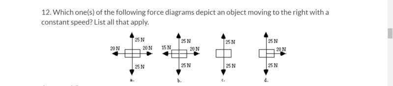

Which object is moving to the right with a constant speed?

Which one(s) of the following force diagrams depict an object moving to the right with a constant speed? List all that apply.
Newtons first law
Four free-body force diagrams labelled a to d showing a box with arrows: a has 25 N up, 25 N down, 20 N left and 20 N right; b has 25 N up, 25 N down, 15 N left and 20 N right; c has 25 N up and 25 N down only; d has 25 N up, 25 N down and 20 N right.
I need help with this question how in the world is it A and C. In A everything is cancelling out so nothing is movingfand nothing moving to the right. In C its not moving to the right. Isnt it suppose to be D since sits going right constant to 20N.

The question says "constant speed". Is the object in 'd' moving at a constant speed ? what about 'b' ?

huh i still don't understand none of them is moving right with a constant speed execpt for d. For a, the box is not moving since in all directions its canceled out. , b is not right, c the box isn't moving. d, is the only one moving right

D has a constant acceleration rightward; not a constant speed (the Ns in the diagram refer to 'Newton', a unit of force).
Where the accelerations in opposite directions are equal, the speed in either of those directions, whatever that speed may be, is constant (see the First Law of Motion).
It may be confusing to you that the question asks which objects are moving rightward at a constant speed when it could as easily have said moving leftward, but the direction of motion has nothing to do with the change or constancy of the speed.
If the accelerations in opposite directions are equal, then in whichever of those directions the object may be moving, in that direction its speed is constant.

Ok but what about C its not moving right
The diagram doesn't show anything about that. It just shows balanced oppositional accelerations in the directions that it shows.
It may be moving right at constant speed. It's certainly moving at constant velocity.

The problem is not telling you that a force was applied (which induced the movement to the right that we are now seeing), and then removed (no additional acceleration or increasing velocity happened after that moment) from the object before the moment or condition they are showing.

I agree the question is poorly worded. It should ask which could be moving to the right at constant speed.
It could also have been made a bit more interesting by removing one of the 25N forces in C, say. Do you see how that could still be an answer?

object at rest stay at rest unless actec upon by external force, object go in straight line forever with constant speed unless acted upon by external force
That's good. A slightly more useful version might be:
"An object at rest stays at rest unless acted upon by a resultant external force; an object goes in a straight line forever with constant speed unless acted upon by a resultant external force"
Resultant force means total force,.
You can now go through the four diagrams in Post #1 and find the resultant force for each. Can you tell us what the four resultant forces are (magnitude and direction)?
